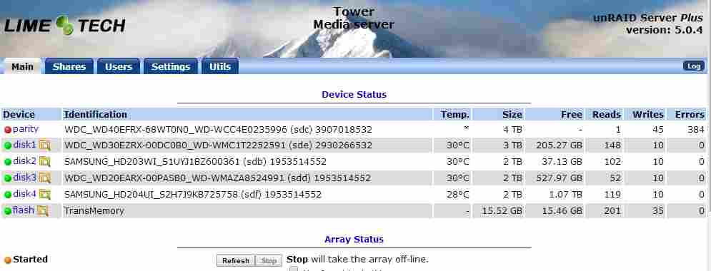

My 4TB WD Red drive recently had a red  ball next to it ( assigned as a parity drive ). I assumed the drive as not heathly so i decided to stop the array and re-do a preclear on the parity drive. The results were no errors.
I tried to reassign the same drive a parity drive once more. After the preclear step, I did not format the drive or create a partition to it. I believe a parity drive does not need a filesystem. Correct me if I am wrong, I'm new to this.
After starting the array, to recreate a new parity, after a few minutes I get a red ball next to the parity drive again. The temperature indicator on the drive changes to *. What could go wrong? The array is now unprotected without parity. How do I solve this?

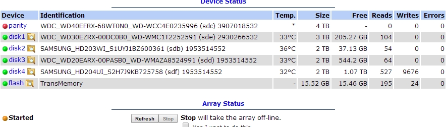

Here is the Syslog and the Management console just after starting the array.
syslog.txt
Unplug and reseat the SATA and power connections on that drive.  Be sure to reseat the SATA connection at the motherboard as well.
I removed and reseat the power and SATA cable for that drive. Problem solved. Thanks.
