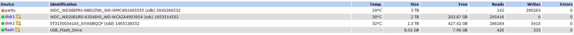

At first, the array consisted of a WD Green 2TB and a Seagate LP 1.5TB drive (see Disk_setup.JPG for exact model numbers).

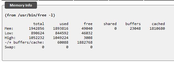

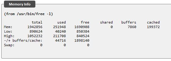

I thought perhaps this was normal (network bottleneck), but then, monitoring memory usage, I noticed that - while things looked pretty normal memory-wise on boot up (with unRAID occupying ~250 megs of RAM) - during transfers there was barely 50MB of free RAM (see HPM_Free and HPM_Free_transfer JPEGs). Again, I thought that this could be normal - perhaps some OS caching.

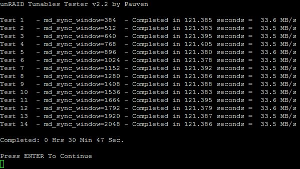

But now, having transferred all files and having added the 3TB Red drive as parity, I run "Tunables Tester" script to fine-tune those tunable values. I was expecting to get a bit of performance boost prior to building the parity (which initially said it'd need 22 hours). To my surprise, the values seem to make no difference, with parity building being capped at 33.6MB/s (see Tunables.JPG)!
This does not seem to match the behavior other setups seem to exhibit when tweaking those values (based on what I see from the above-linked thread).

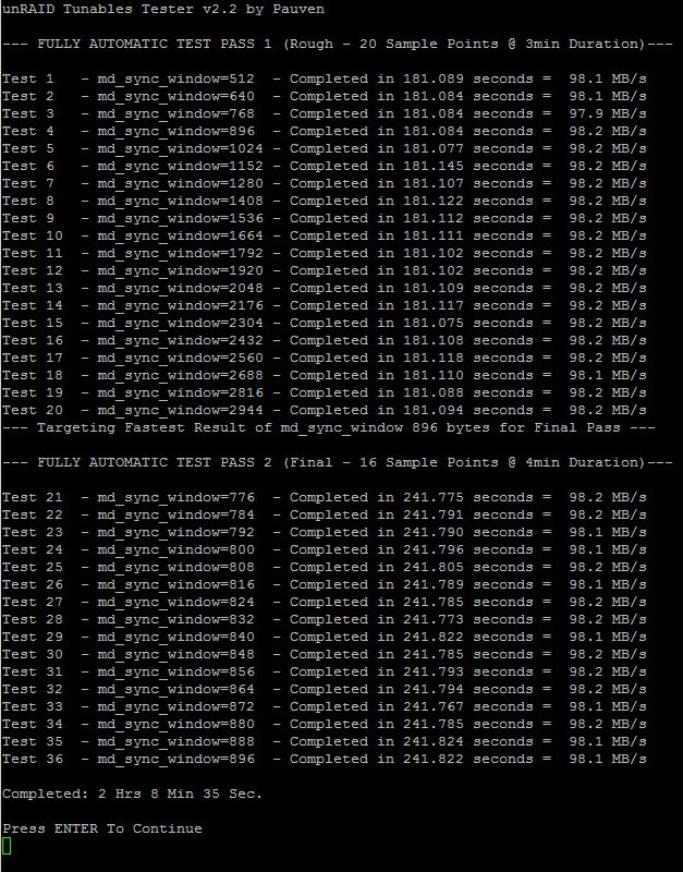

Installed the latest HP BIOS on the Microserver (a modded version, to be exact).
Not sure if it's related to the BIOS update but I re-run the tunables script and, while a cap is still evident, performance is way better now (~ x3 times the initial one - see attached).
