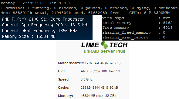

Xen only seems to see half of the memory I have installed.  Both the BIOS and the unRAID webGUI recognize the full 16GB of memory that is installed in the system.  However, if I run "xl info" or "xl top", Xen only shows that I have a total of 8GB of memory.  Therefore, if I try to allocate 6GB or more to the VM, Xen errors out saying it is out of memory, even though I should have 14GB free after allocating 2GB to unRAID.
I tried reformatting my flash drive and starting over from scratch in case I screwed up some settings somewhere, but even with the stock unRAID, it still only shows 8GB.
Is anyone else experiencing a similar issue and/or does anyone have any suggestions for me?

It is starting to look more like a hardware issue though.  I just started running Memtest86 and while it shows 4 GB in each of the 4 slots, at the top, it is only showing 8GB of total memory.  I will try to mess around with the hardware to try to determine the problem.  Thanks for the help.

Thanks guys.  I reseated the memory and everything is working great now! :)
