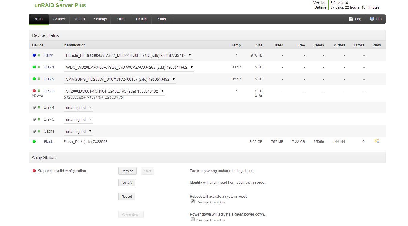

Last week I came home to an unresponsive server. I believe my disk 3 is dead (showing "wrong" , I/O errors) but before I swap that out with the new one I want to make sure I'm doing the right thing. My parity is show up blue dot and I'm hoping to rebuild the troublesome drive from that.
Is the parity screwed? what should I do from here? I figure I should ask before I lose all my data. Syslog and screenshot attached. Version 5.0 beta14

So the blue dot means it's a new drive? It's not a new drive, been using it for over a year. Is there a way to mount it or trust it?
Is it just showing blue because one of the drives are broken/ gone/ unusable and needs to rebuild?

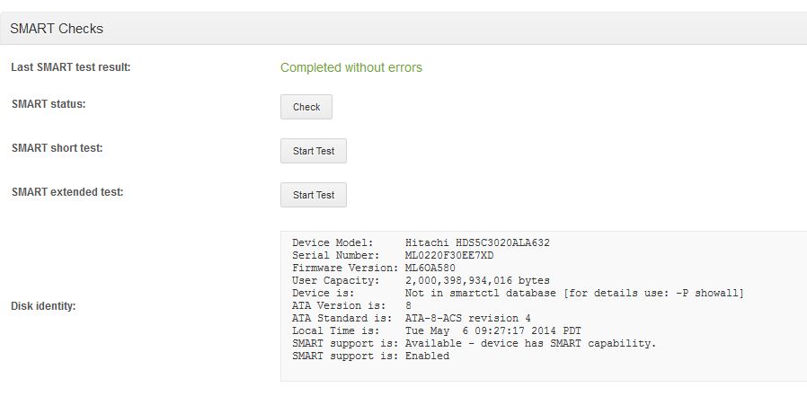

Report for parity attached, just finished the extended test without errors (not sure how to export that to .txt doc). Disk 3 fails to create a report, I/O error (edit disk 3 attached, smart_dead.txt).
ParitySmart.txt
smart_dead.txt
