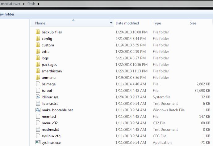

You need to copy bzimage and bzroot to the root of the flash drive -- i.e. if you go to \\tower\flash  you should see the correct versions of bzimage and bzroot (2,662KB for bzimage;  32,698KB for bzroot).
I have checked the \\tower\flash directory and it shows the correct file dates and size for both bzimage and bzroot.  I have attached a screen shot of the directory.
Any other thoughts?
The file dates don't match the latest download -- so I'd re-download it and try again.

I finally figured it out, I was not booting off the USB, but a transparent boot image that I built because the motherboard was having an issue with seeing the USB at boot.  Once I modified that with the updated files, everything worked correctly.  That is waht I get for setting it up and not touching for over a year.
Thanks for all you help and I apologize for my brain-lock...
Glad you figured it out -- it was a bit perplexing that the flash drive showed the correct sizes for the key files, but the system wasn't booting to that.    That's why I asked if perhaps you'd simply stopped & restarted the array without actually rebooting.
