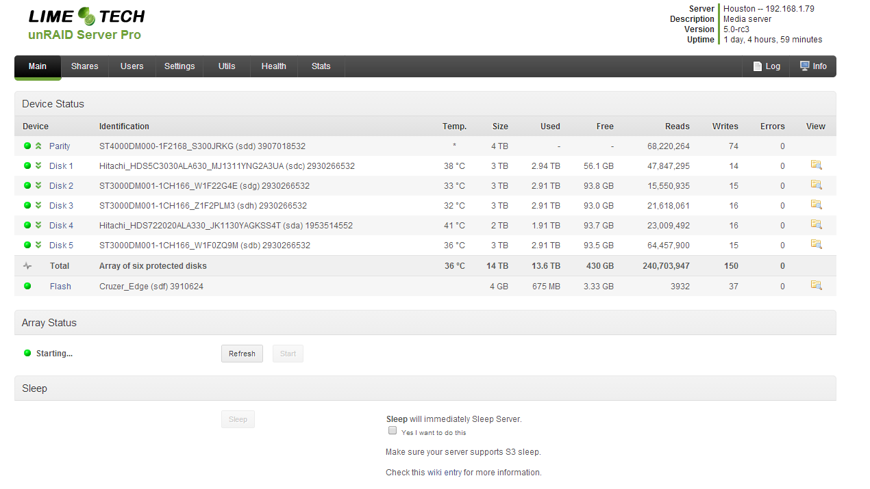

I tried to expand my array with a 4TB disk, I thought was precleared.. then it started preclearing it.  So I shut down as gracefully as it would let me and I pulled the drive.  I restarted the array without the drive then I started a preclear (v1.15) again.  When I restarted the array it started a Parity check.. ok... no errors... but there were missing menu items. I figured they may come back after the Parity check but they did not.  I also noticed my cache drive is not present.  Maybe a loose cable.  Anyway I am going to wait until tonight after the preclear is done. before I reboot or anything... can anyone explain this weird menu?

The other odd thing I forgot to mention.. None of the shares are available.  I can only access flash.
Its as if the array is on some kind of safe mode.  I assume there is someway to have unraid forget the configuration and just rebuild parity if I needed to.

It sure looks to me like the array is having a problem starting (hence the "Starting ..." array status message. Again, the syslog may provide hints. Gizzard said the only share his sees is the flash, which is consistent with an array that is not started.
There is a mode called maintenance mode that will bring the array online but not mount any disks. This is selectable from the Web page (as opposed to safe mode that is completely different that is available from the boot menu). Did you select that option when you started the array?

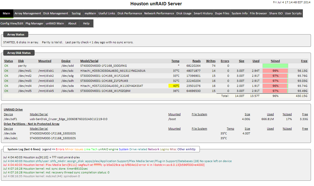

Attached is the syslog and the unmenu pic which shows my second 4TB drive which is not in the array, but is currently 83% through its post-read step.

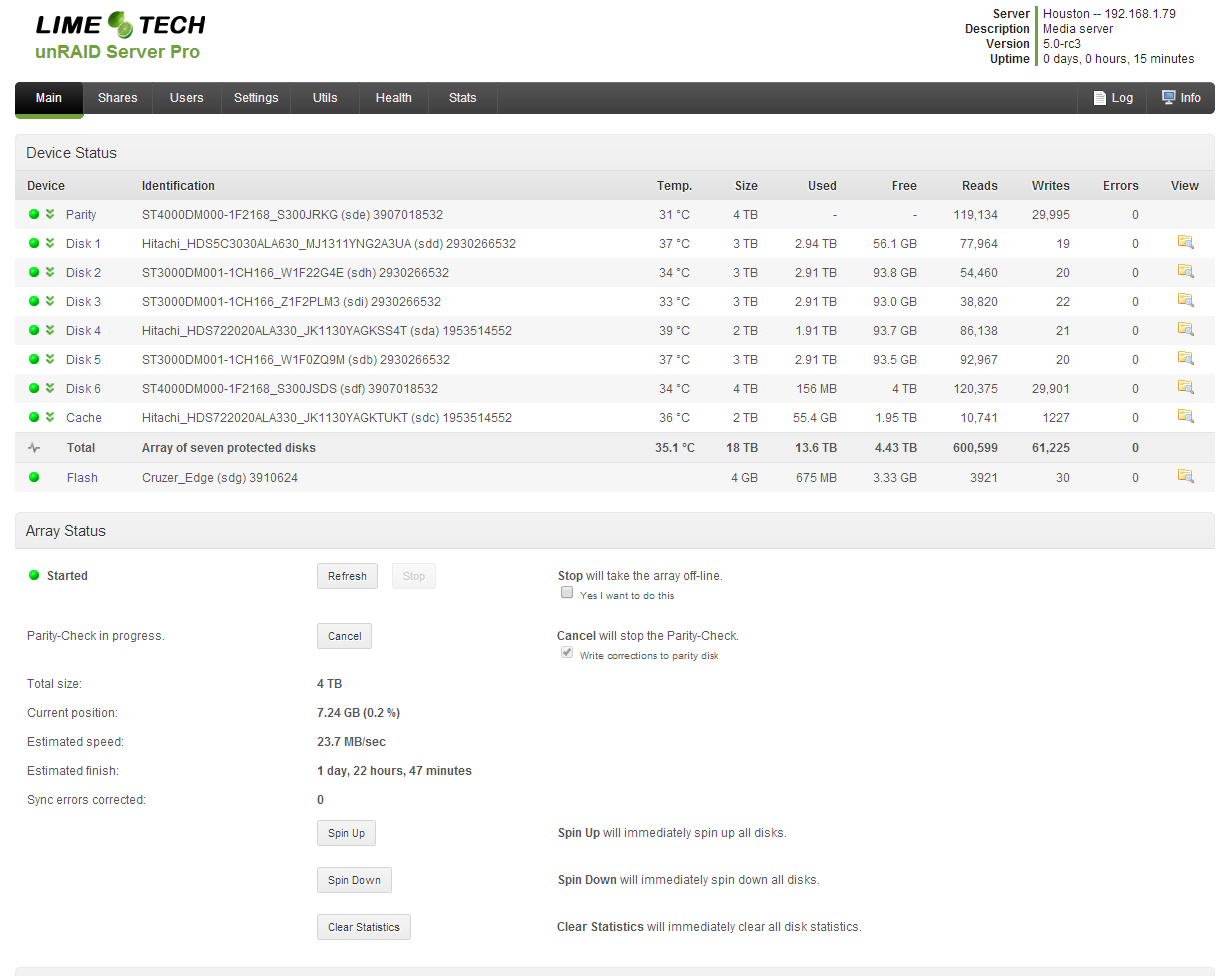

Hurray.  After pre-clear and preclear -t I was able to start the array, and add both the new 4T drive and my 2T Cache drive that the power cable fell out on....
See this pretty picture below!  Thanks all for the help!!
