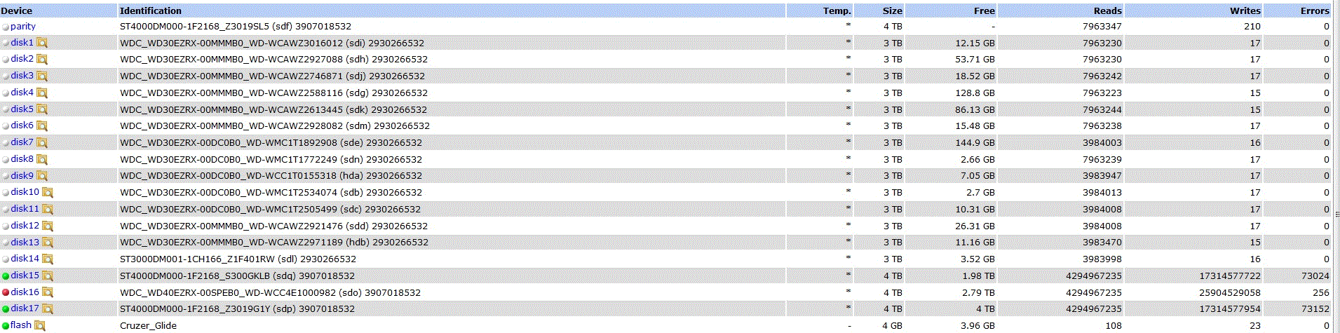

July 17, 201412 yr I've been running unRAID fairly error free for about a year and a half but after running out of storage space, I added a 4 bay Sans Digital enclosure (based upon several recommendations posted on here). Since then, I've had three drives give me write failures. First two were both from the same HDD batch, so I thought I just had a couple bad drives. After replacing them with different brands, still had the same errors though...and here I am. The odd thing that I noticed was that after running all drives error free for several days or weeks, the GUI would show errors on 3 drives (with two having identical stats). After restarting, it would only show one as having write errors though. A bit on the specs: Running unRAID Pro 5.0-r16c Mobo: ASRock 880GM-LE FX CPU: AMD Athlon II X2 270 Regor Dual-Core 3.4GHz 3 Norco 5 bay enclosures SUPERMICRO AOC-SASLP-MV8 PCI-Express x4 Low Profile SAS RAID Controller SYBA SY-PCI40010 PCI SATA II (3.0Gb/s) 4 Port RAID 0/1/5/10 JBOD Card SYBA SY-PEX40038 PCI-Express 2.0 SATA III (6.0Gb/s) Controller Card Sans Digital 4 Bay eSATA Port Multiplier JBOD Tower Storage Enclosure Syslog attached and I can get the SMART reports tomorrow if necessary. I'm a bit of a novice at this, so any help is appreciated. syslog.txt
July 18, 201412 yr Author Screencap of the errors during data rebuild. Why does it show errors on 3 discs, but only one is red? Notice how the read numbers are exactly the same for 15, 16, 17 which are the discs in the Sans Digital case.

July 19, 201412 yr Smart reports look fine. I can only guess that the overall cable length from the controller to the disk is too long. I am not familiar with the Sans Digital unit you are using, have have had problems with eSATA enclosures for this exact reason. A shorter cable fixed it for me.
