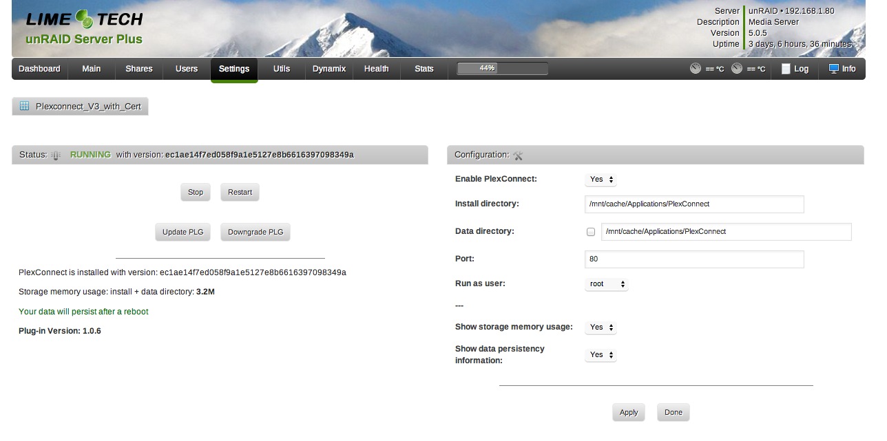

July 20, 201412 yr I Run PlexConnect using this plugin with no issue at all. Make sure you install and change all the dirs to your cache drive as otherwise will wipe all settings on each reboot. Be aware that when you press upgrade it can take a little time so be patient. http://lime-technology.com/forum/index.php?topic=33341.msg306949#msg306949
