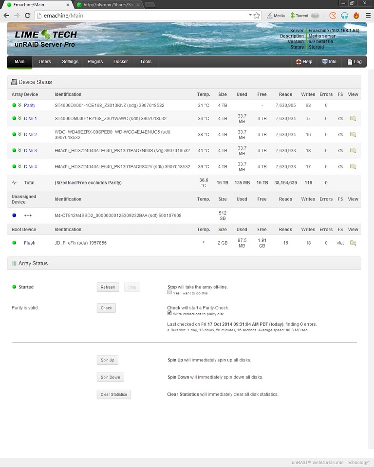

Upon completion of a Parity Check, there are a couple of lines (the second being new in version 6).
The first line states: Last checked on ..., finding 0 errors.
The second line states: > Duration: ..., Average speed: ...
I'm seeing the average speed not matching the size / duration.
How to reproduce:
I believe this will happen any time the duration of a parity check exceeds one day.
Expected results:
In my case I expected to see a number near 30MB/s for my 4TB parity check with duration about 1 day, 14 hours.
Actual results:
Instead I saw an average speed reported near 80MB/s, a quick check shows that it's consistent with losing the day off the duration (i.e. just 14 hours was used in the calculation).
Other information:
Screen capture attached.
I've captured the syslog for the session pictured, but doubt it will be necessary to fix this problem.

I've got another data point:
Duration: 1 day, 8 hours, 49 minutes, 13 seconds. Average speed: 126.0 MB/sec
This result is consistent with the theory that the number of days is not being considered in the average speed calculation.

The duration in seconds reported in the log *is* correct.
I can send Tom a note . . . didn't realize that was part of the process.
I'll send him a note and point him to this thread.    Very interesting that the seconds are reported correctly -- clearly that simply means there's an error in the display logic, NOT in the actual timing of the check.    But that error is carried forward into the average speed computation as well -- so clearly it should be fixed.
Thanks Gary.
Note that the "Duration" displayed on the web GUI *is* correct, only the "Average speed" drops the days part.
Thanks Gary.
