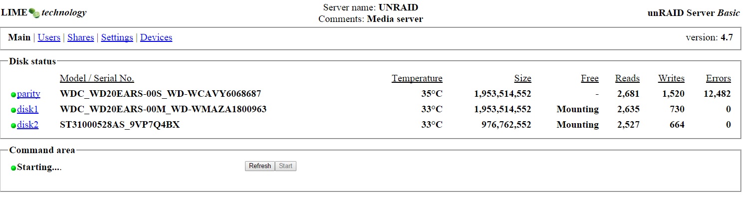

My unraid box has been running for a few years now without any major problems.  About 4 months back I had an issue with the parity drive and I did a parity recheck on it and then life was good.  Well, I was copying a movie to the unraid box this evening and it just kind of locked up.  It just stopped responding and I couldn't do anything, so I had to press the power button and power it down.  Now it has some what come back up, but I am having some major issues with it.  I can't access the unmenu.  I can telnet into it, but I am not an expert without any guidance on using any commands under the root menu.  I have done some preclear_disk using the telnet but that is about it.  So, if I go to the ip address of the unraid box, it takes a long time to navigate from tab to tab, but on the "main" tab, the three drives "parity" and "disk1" and disk2" all are green.  The parity drive is up to at 9,385 errors and going up, with 1,446 writes.  Below the command area it says "starting".
So, before I go messing something up anyone have any advice on what todo?  Did my parity drive fail?  I have another 2 TB parity drive on order, but it won't be here till Friday.  Should I wait till Friday and just power down the box, and replace the parity drive and let it do a parity rebuild?  Is there anything I can try in the mean time through the telnet under the root menu? Do I need to let it finish error on the parity drive, then I can stop and unmount the parity drive?
Any help or advice would be super appreciated. Thanks....
The parity drive is a "WDC_WD20EARS" green drive, so maybe my luck of not having a red drive caught up to me.  :-(
I was copying a movie over to my unraid box, and it just kind of locked up.
[/img]
Syslog report it attached in zip file.

The smart report does not look good.

Yes. You have several SMART values that are worrisome. See here
