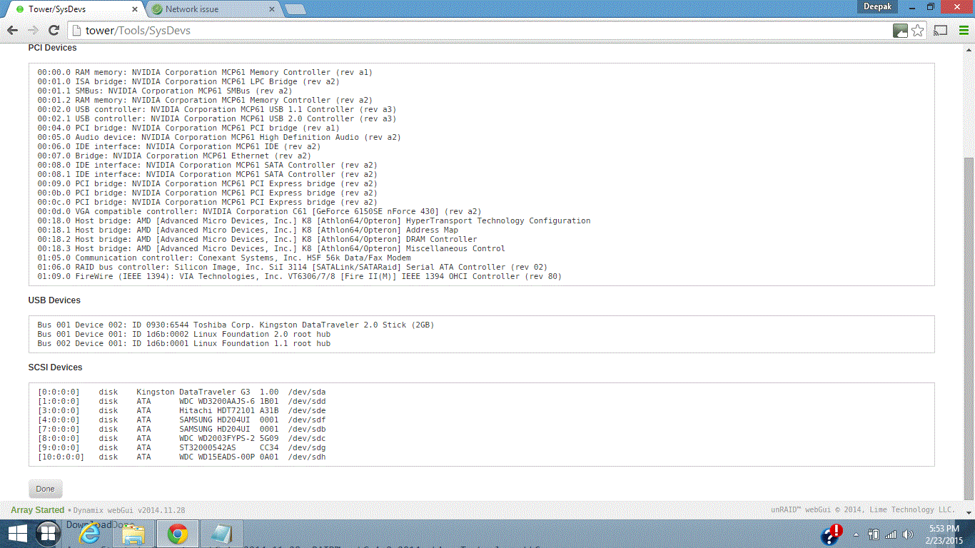

Give us a better description of your unRAID server-- CPU, MB, size of RAM, number of HD's.

Attached pic shows my system info - cpu, ram, hdds, etc.
