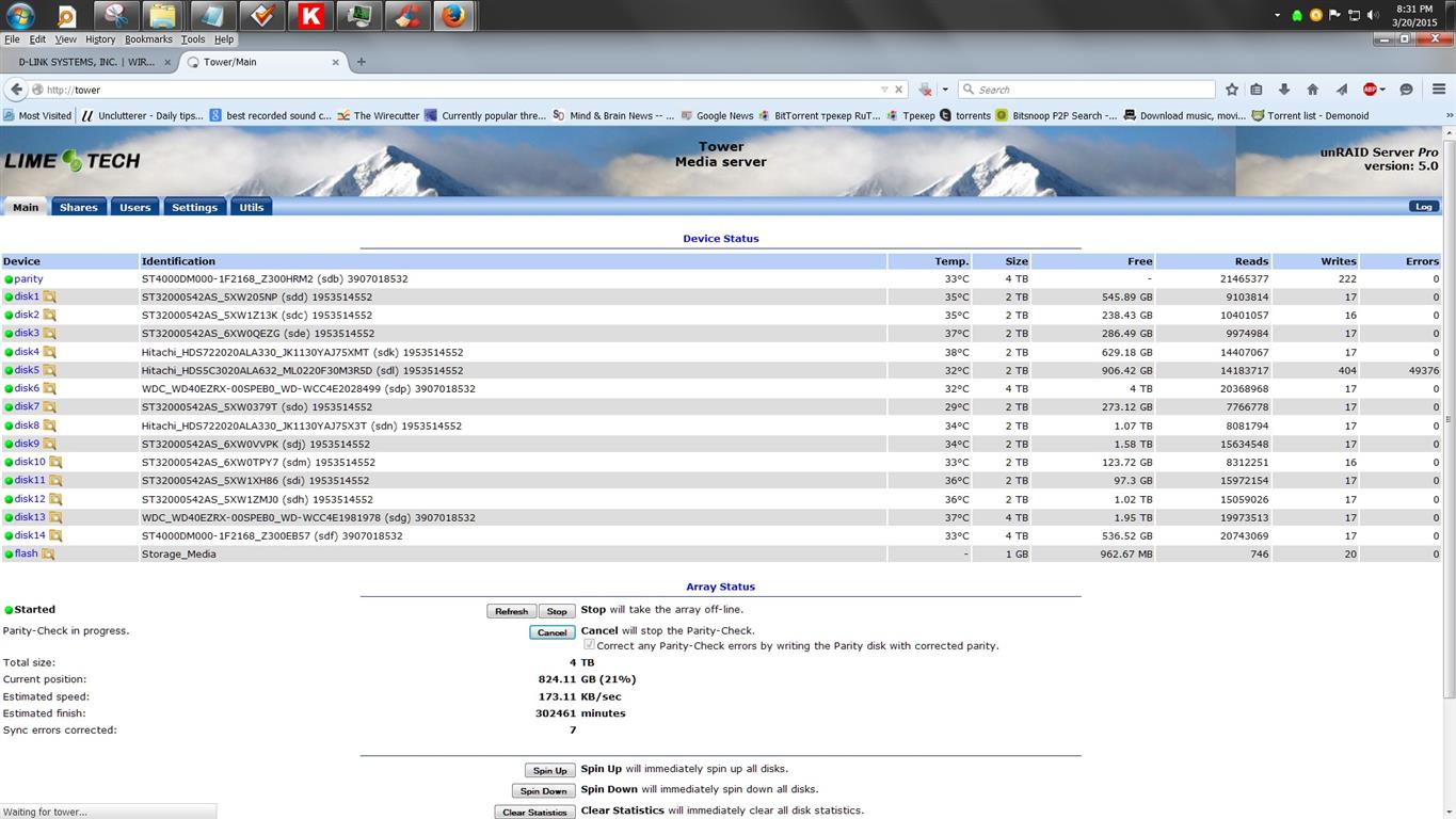

My server was off for a few months and when I went to turn it on everything booted up as normal. I decided to do a parity check with corrections and found 38 errors before the server start to become non-responsive. I was able to do a clean shutdown and restarted parity with corrections, again finding the 38 errors that were corrected with no further problems and parity check was completed. I proceeded to do a second parity check with corrections and started to find problems with disk 5 and additional errors. I was able to stop parity check and my server is just sitting idle before I make my next move. I've enclosed a log for review that shows a lot of errors happening on disk 5.

I've enclosed a print screen that shows what I was seeing from the web GUI for review as well.

Your first correcting check finding 38 errors, then the next one finding the same 38, means to me that one of the disks - disk5 at high suspicion - was returning bad data. The first 38 were likely wrong, and the second 38 corrected the first 38.
Could be a bad cable but could easily be a bad drive. I find nothing is worse for drives that keeping them cold for months / years at a time with no use.
