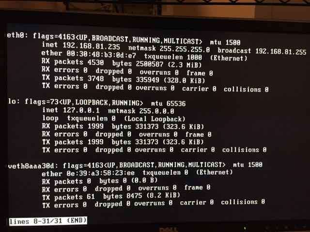

August 20, 201511 yr Author i got the syslog at the command line copied to the usb drive and manually moved to my laptop. attached is a photo of my ip config for eth0. the MAC address ending in e7 is the MAC address of the only ethernet port on my motherboard. and, the one apparently assigned 192.168.2.22 in the syslog. thx again.
August 20, 201511 yr As you can see from the picture, the IP address is not 192.168.2.22, but rather 192.168.81.235. Looking at the system log, it seems that you have two DHCP servers responding (192.168.2.1 and 192.168.81.1). In the end, the system decides to go with 192.168.81.235 rather than 192.168.2.22. If your router is 192.168.2.1, figure out what device 192.168.81.1 is and disable the DHCP server on that device (or move it to a separate network).
