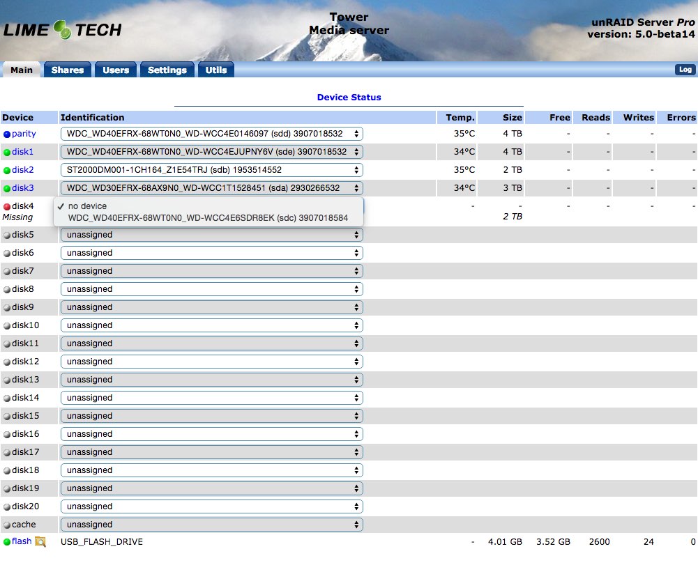

Noticed that the server shares started becoming unresponsive the other night, so jumped on the Web GUI, saw that a data drive had started to report errors. Because it was late at night, I stopped the array, and shut the server down through the GUI with no issues.
The following day, I booted the server again and one of the data drives had the beep of death after spinning up a little while. It was actually locking up the BIOS at startup, so I replaced it with a new drive and started the system again.
Now when I start up the server, the Parity Drive is showing a blue dot ! It's the same drive assignment and everything ... and the parity was valid last week when I last checked the system. The new drive is appearing in the drop down list for assignment as the replacement data drive.

Sceenshot attached ....
It's been awhile since I've seen v5, but are you sure that's an error?  What happens when you assign the new drive as Disk 4?  What is the description (next to the Start button) of what happens if you click Start?  Can you give us a screen shot of that?

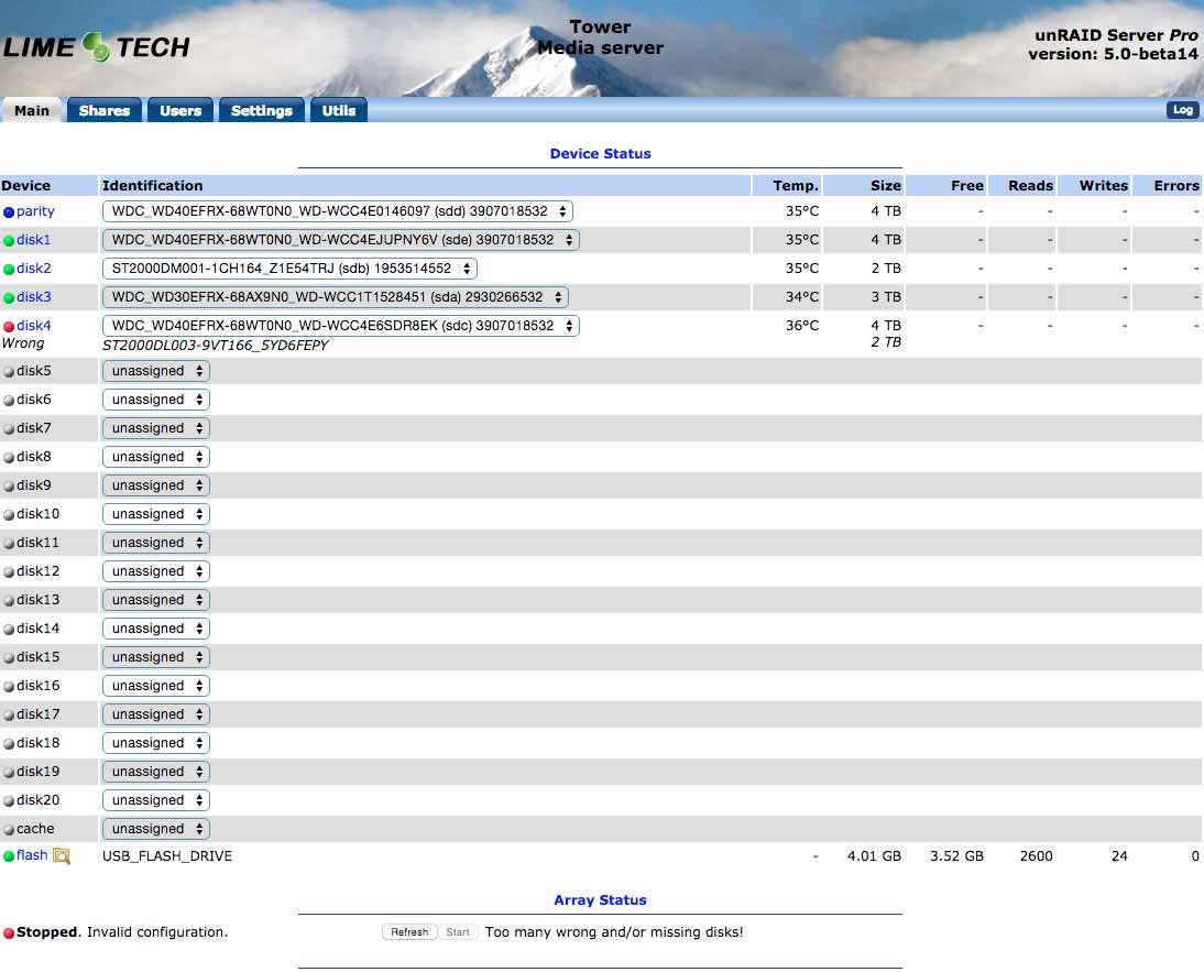

I thought the same ... but the system still reports too many wrong/missing disks. ( see attached )

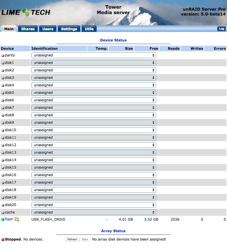

Try the super.dat that I've attached.  It's the same as yours with one byte patched, I think, to indicate the parity drive is fine.
super.zip
Thanks Rob !
Unfortunately, it looks like it invalidated the configuration .... ( see attached )
Maybe a checksum (?) needs modifying as well.
