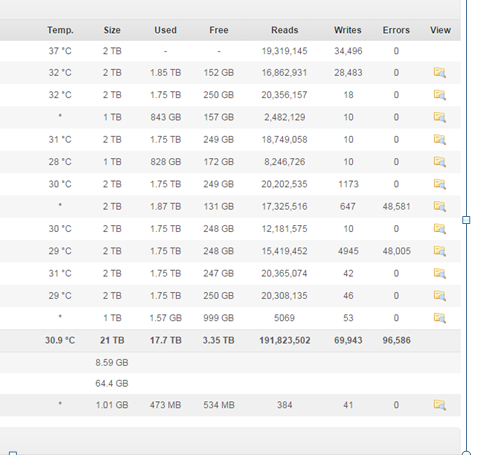

I have errors showing on 2 drives... what is the best way to proceed? Replace 1, rebuild, then replace the other?
Or replace both (via clone tool or other, and then rebuild)?
attached is screen shot. thanks.

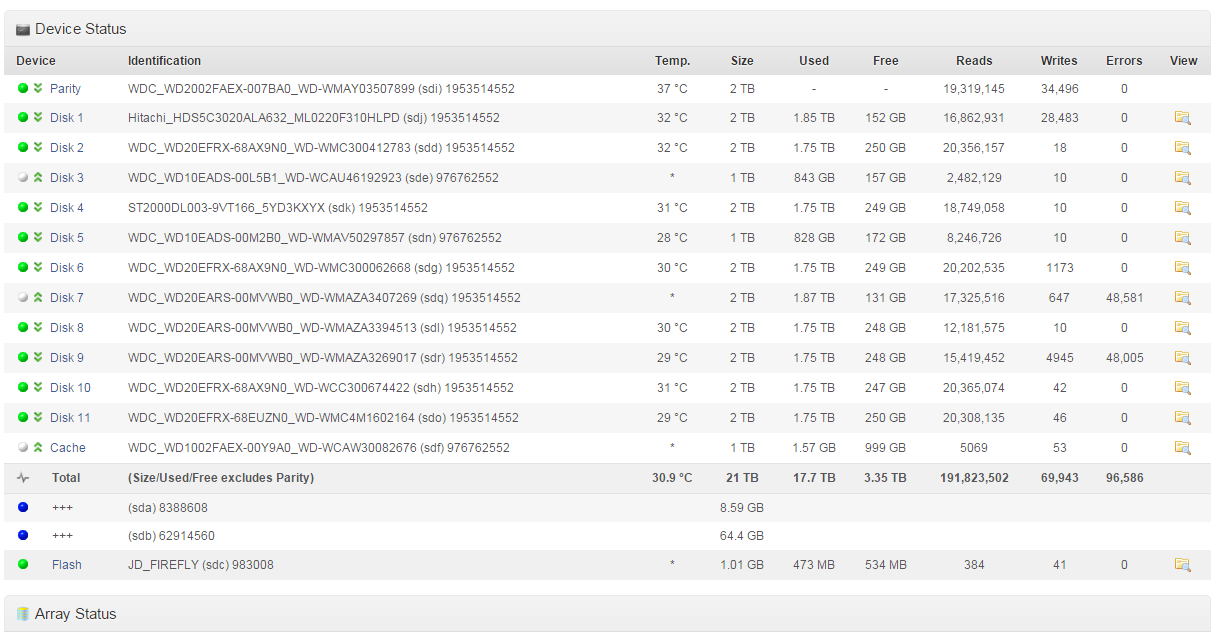

Here is a larger screen shot: v 5.0.5 is what i'm running.
Not sure what a full syslog will do, as its 21kbytes in size and mostly filled with the error I posted, and some private information (files, etc, I'd rather not share, is there some way to clean file names out quickly?).
I would really apprciate some advice on the best way to replace the 2 failing drives (they are 4.5years old WD Green drives, so not warranty, and need replacing, so would like advice so I can decide on the best method).
Thanks!

disk9 (sdr in screen shot, but now sdm for some reason, perhaps because I stopped the array and assignments can sometimes change on my IBM controller?)

edit: snippit from syslog (can post entire thing if you really want?):
We ALWAYS want!  You are welcome to clean out anything personal or private (so long as you keep the file a text file), but we HAVE to have the entire syslog to see the beginning setup and the very first errors that occurred.  The errors that occur later are almost never interesting, as they are often just consequences of the original problem.  It's the errors associated with the cause of the problem that we need to see.  If you prefer, you can chop off the last 3/4ths of the file, all the redundant errors.  Then zip the syslog and attach it (it compresses to almost a tenth), or post a public link to the zip.
Disk 9 looks great, no issues.  Disk 7 has a few bad sectors (Current_Pending_Sector count is 2), needs to be tested and replaced.
I strongly recommend avoiding ANY writing to the array.  To rebuild Disk 7, you will probably have to trust parity and the current Disk 9.  Then you can rebuild onto a new 2TB drive newly assigned to Disk 7.  Once the current Disk 7 is out, you can Preclear it a couple of times, make sure no more current pending sectors, and hopefully reuse it.
Thanks RobJ ... here is the top portion of my syslog showing when the errors started (the rest of the log was 99% of these errors repeating themselves). So hopefully this helps and  you can guide me better!!
APPRECIATE IT!
syslog-2015-09-11_sm.zip
Syslog is fine for days, with Disk 7 at sdm (sd 3:0:1:0) and Disk 9 at sdp (sd 3:0:4:0).
Then it appears you hot-plug a drive in at Sep 10 17:09:20, to slot sd 3:0:5:0, about 10 minutes after Disk 7 spun down.  It's assigned the drive symbol sdq.  It looks like this -
Sep 10 16:59:05 RCNAS kernel: mdcmd (2813): spindown 7
Sep 10 17:09:20 RCNAS kernel: sd 3:0:1:0: [sdm] Synchronizing SCSI cache
Sep 10 17:09:20 RCNAS kernel: Result: hostbyte=0x01 driverbyte=0x00
Sep 10 17:09:20 RCNAS kernel: mpt2sas1: removing handle(0x000a), sas_addr(0x4433221101000000)
Sep 10 17:09:27 RCNAS kernel: scsi 3:0:5:0: Direct-Access    ATA      WDC WD20EARS-00M AB51 PQ: 0 ANSI: 6
Sep 10 17:09:27 RCNAS kernel: scsi 3:0:5:0: SATA: handle(0x000a), sas_addr(0x4433221101000000), phy(1), device_name(0x0000000000000000)
Sep 10 17:09:27 RCNAS kernel: scsi 3:0:5:0: SATA: enclosure_logical_id(0x500605b00372dfc0), slot(2)
Sep 10 17:09:27 RCNAS kernel: scsi 3:0:5:0: atapi(n), ncq(y), asyn_notify(n), smart(y), fua(y), sw_preserve(y)
Sep 10 17:09:27 RCNAS kernel: scsi 3:0:5:0: qdepth(32), tagged(1), simple(0), ordered(0), scsi_level(7), cmd_que(1)
Sep 10 17:09:27 RCNAS kernel: sd 3:0:5:0: Attached scsi generic sg12 type 0
Sep 10 17:09:27 RCNAS kernel: sd 3:0:5:0: [sdq] 3907029168 512-byte logical blocks: (2.00 TB/1.81 TiB)
Sep 10 17:09:27 RCNAS kernel: sd 3:0:5:0: [sdq] Write Protect is off
Sep 10 17:09:27 RCNAS kernel: sd 3:0:5:0: [sdq] Mode Sense: 7f 00 00 08
Sep 10 17:09:27 RCNAS kernel: sd 3:0:5:0: [sdq] Write cache: enabled, read cache: enabled, doesn't support DPO or FUA
Sep 10 17:09:27 RCNAS kernel:  sdq: sdq1
Sep 10 17:09:27 RCNAS kernel: sd 3:0:5:0: [sdq] Attached SCSI disk
The messages with sdm look completely innocent, but after this the next mention of Disk 7 involves read errors, so it (sdm) wasn't responding.
Almost the same thing happens again in almost 2 hours, this time involving Disk 9 and a second new drive that appears to be hotplugged in.  It's plugged into sd 3:0:6:0 and assigned sdr.
Sep 10 18:50:51 RCNAS kernel: mdcmd (2823): spindown 9
Sep 10 18:50:52 RCNAS kernel: mdcmd (2824): spindown 10
Sep 10 18:50:52 RCNAS kernel: mdcmd (2825): spindown 11
Sep 10 19:12:54 RCNAS kernel: sd 3:0:4:0: [sdp] Synchronizing SCSI cache
Sep 10 19:12:54 RCNAS kernel: Result: hostbyte=0x01 driverbyte=0x00
Sep 10 19:12:54 RCNAS kernel: mpt2sas1: removing handle(0x000d), sas_addr(0x4433221102000000)
Sep 10 19:13:02 RCNAS kernel: scsi 3:0:6:0: Direct-Access    ATA      WDC WD20EARS-00M AB51 PQ: 0 ANSI: 6
Sep 10 19:13:02 RCNAS kernel: scsi 3:0:6:0: SATA: handle(0x000d), sas_addr(0x4433221102000000), phy(2), device_name(0x0000000000000000)
Sep 10 19:13:02 RCNAS kernel: scsi 3:0:6:0: SATA: enclosure_logical_id(0x500605b00372dfc0), slot(1)
Sep 10 19:13:02 RCNAS kernel: scsi 3:0:6:0: atapi(n), ncq(y), asyn_notify(n), smart(y), fua(y), sw_preserve(y)
Sep 10 19:13:02 RCNAS kernel: scsi 3:0:6:0: qdepth(32), tagged(1), simple(0), ordered(0), scsi_level(7), cmd_que(1)
Sep 10 19:13:02 RCNAS kernel: sd 3:0:6:0: Attached scsi generic sg15 type 0
Sep 10 19:13:02 RCNAS kernel: sd 3:0:6:0: [sdr] 3907029168 512-byte logical blocks: (2.00 TB/1.81 TiB)
Sep 10 19:13:02 RCNAS kernel: sd 3:0:6:0: [sdr] Write Protect is off
Sep 10 19:13:02 RCNAS kernel: sd 3:0:6:0: [sdr] Mode Sense: 7f 00 00 08
Sep 10 19:13:02 RCNAS kernel: sd 3:0:6:0: [sdr] Write cache: enabled, read cache: enabled, doesn't support DPO or FUA
Sep 10 19:13:02 RCNAS kernel:  sdr: sdr1
Sep 10 19:13:02 RCNAS kernel: sd 3:0:6:0: [sdr] Attached SCSI disk
Sep 10 19:39:05 RCNAS kernel: md: disk9 read error, sector=2162691968
Sep 10 19:39:10 RCNAS shfs/user: shfs_readdir:
Sep 10 19:39:10 RCNAS shfs/user: shfs_readdir: readdir_r:
Sep 10 19:39:10 RCNAS kernel: md: disk7 read error, sector=2162691968
Sep 10 19:39:10 RCNAS kernel: REISERFS error (device md9): vs-13070 reiserfs_read_locked_inode: i/o failure occurred trying to find stat data of [20369 188461 0x0 SD]
Sep 10 19:39:10 RCNAS kernel: REISERFS (device md9): Remounting filesystem read-only
26 minutes afterward, a read of Disk 9 is attempted and failed, plus Reiser file system corruption is detected, so Disk 9 is remounted read-only, which is going to fail even more I/O.
It takes awhile but both drives report a lot of read errors and Disk 9 reports a lot of file system errors, then Disk 7 also is corrupted, and remounted read-only.
My comments so far are strictly based on the syslog.  Now when I look at your second screen pic, I'm amazed!  Disk 7 shows as sdq(!) and Disk 9 as sdr!  So it seems like what *looked* like a hotplug event was either a serious bug in the driver or it thought it was disconnected then was quickly reconnected and it set it up as a new drive, which would be fatal for unRAID.  The message "removing handle" must be indicating it was dropping the drive.
If you stop the array, then unRAID does a new inventory and recognizes the drive by their serials, so picked up their drive device symbol changes, without even noticing they had changed!  You commented "sdr in screen shot, but now sdm for some reason".  I suspect that Disk 9 had another pseudo 'hotplug event', and it was re-assigned a drive device symbol of sdm, because sdm was now available, no longer in use (used to be Disk 7).
I have no idea what happened.  The SAS error handler is singularly uninformative, did not say anything about drives being disconnected, didn't explain anywhere what was wrong.  Perhaps the drives are loose, or vibrated loose?  What's really bazaar is the drives are reported to be moved to completely different physical slots (sd 3:0:1:0 to sd 3:0:5:0, and sd 3:0:4:0 to sd 3:0:6:0).  Is there any chance that someone pulled the drives out and pushed them back in, into different trays?
What I *can* say is that it's not the fault of the drives.  They appear to be fine.  Disk 7 does have pending sectors, but they weren't involved in the problems above.
Something else I can't help you with -

Jul 21 22:10:59 RCNAS kernel: Guest personality initialized and is active
Jul 21 22:10:59 RCNAS kernel: VMCI host device registered (name=vmci, major=10, minor=59)
Jul 21 22:10:59 RCNAS kernel: Initialized host personality
Jul 21 22:10:59 RCNAS vmsvc[1494]: [ warning] [GLib-GObject] invalid (NULL) pointer instance
Jul 21 22:10:59 RCNAS vmsvc[1494]: [critical] [GLib-GObject] g_signal_emit_by_name: assertion `G_TYPE_CHECK_INSTANCE (instance)' failed
It's VMWare related, which I have no experience with, but anything reporting a 'warning' then 'critical' I pay attention to!  It seems to involve the VMCI device, again something I don't know anything about.  I suspect something here is broken.
I have dual M1015 IBM (LSI) controllers flashed to IT mode passed through to unRaid.
I didn't hot-swap or change anything on this machine for a long time... it only powered down in July due to a storm (I was even home so it was properly shutdown before battery backup failed).
Sounds like either an issue with VMWare pass-through, or linux driver.  I've rebooted the machine and started the rebuild process for the one disk; finger crossed that the issue is solved from a full reboot (the hardware completely shutdown to do the swap of drive to be safe) has cleared the driver/raid pass-through issue.
Thank you again for an awesome analysis of my syslog!
