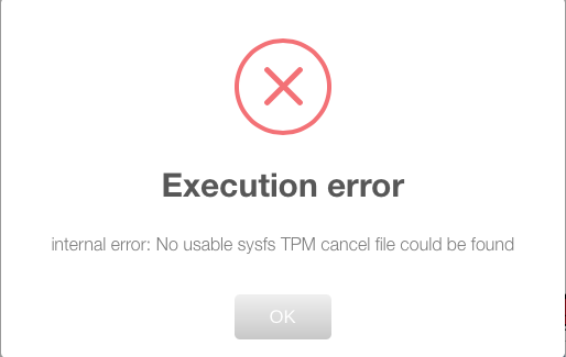

Hello,
I gave a shot myself editing the XML code however with little luck. What would be a suitable location to ask someone to take a look at this issue?
Thanks in advance for a reply.
  • 5 months later...
I also am getting this error, unRaid 6.4.1 appears to not add the TPM to the dev folder, and so there is nothing to pass through into the VM...
