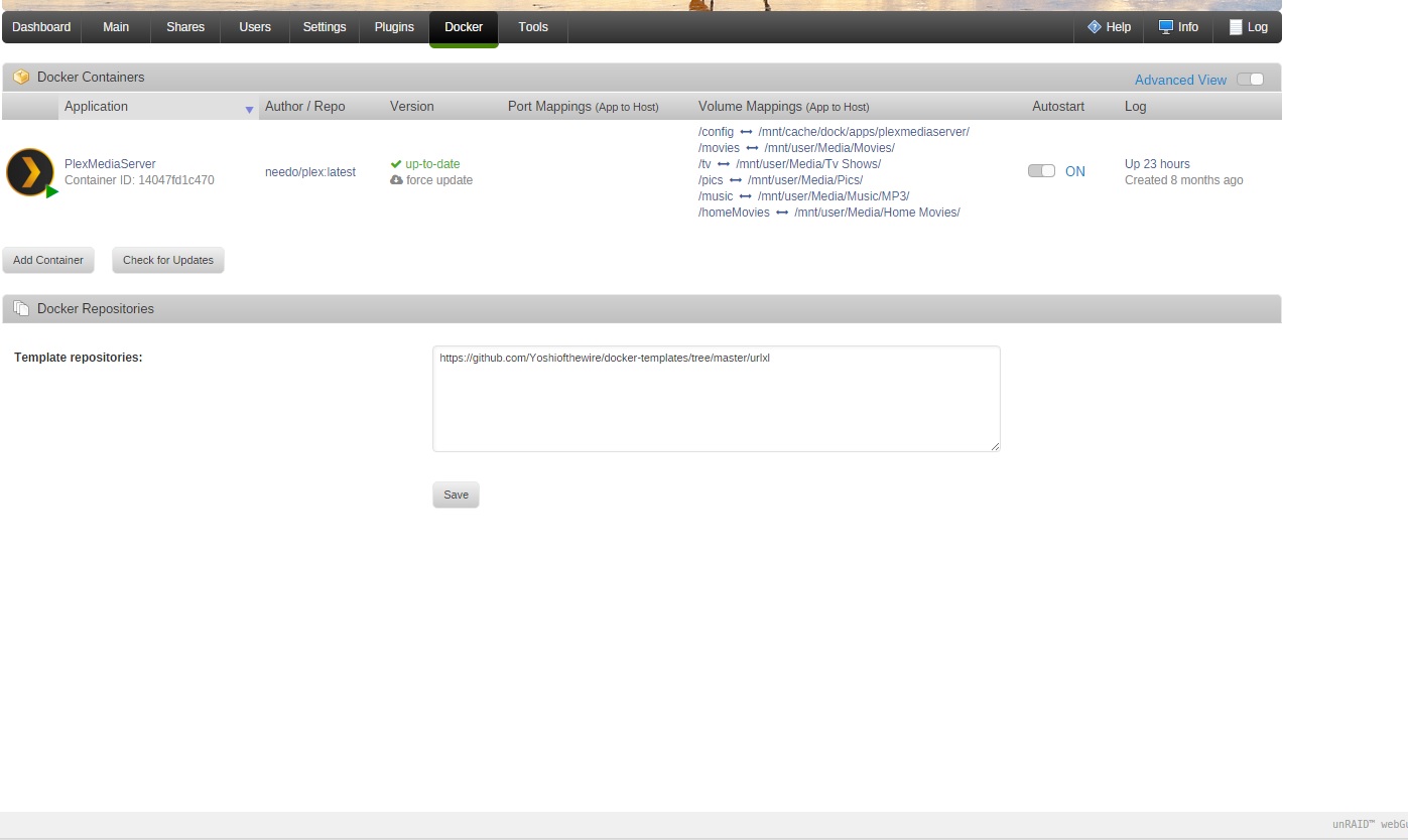

I'm trying to get the HDhomerun Docker installed using this repository:
https://github.com/Yoshiofthewire/docker-templates/tree/master/urlxl
Found in this thread: http://lime-technology.com/forum/index.php?topic=45719.15
However, regardless of whether I add that to my box of repositories, or make it my only one, or even have none listed... I get the same list of templates to choose from when I select Add Container.  I've tried logging out, closing the window, disabling/re-enabling dockers, nothing seems to change it.
I'm I running into a caching issue of some sort, or am I doing something wrong?

Since yoshi never asked to have the repo put into CA (no idea why), you're stuck with using a repository to access it.
Repositories are a PITA, due to formatting, etc.  IIRC you've got to make sure that you have an enter after each line.  Can't remember, but you might also have to hit check for updates
Hmm i tried hitting enter twice after the line.  I also had it check for updates, but no dice.  I still don't see it listed.
It's gotta be something I'm doing wrong since others in the thread got it to install.  Just clicking on the link takes me to the tree and directory with the XML file.
