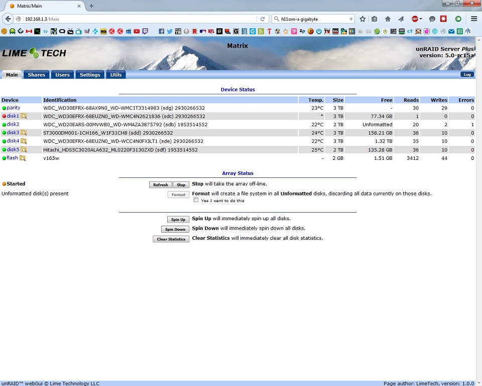

I found out after posting that I had someone connected to my plex server watching a show when I shut down the system. Don't know if this could have played a part in the hard drive becoming corrupted or whatever happened with it. After posting I also reinstalled all the old hardware and it told me that disk1 was invalid and needed to be rebuilt which I did today while sleeping. Everything seems to be fine now.

The drive seems to be fine now. Don't know exactly what happened. I think because I am impatient and a daredevil lol, I am going to upgrade to v6 tonight, then swap the hardware again and see how it goes. If I run into anymore problems I will probably just wait till the new card comes in.
Disk 1 I got the red ball on, which was the one I had to rebuild today. Disk 2 was the one that showed as unformatted.

Thanks for the picture.  One of the problems with v4 and v5 is that red ball info was never logged, so I saw no evidence of any problems with Disk 1 in the syslog.  All of the problems involved Disk 2 (which I still think should be examined more closely, the SMART report).  v6 makes it easy to check it, and run a long SMART test.  v6 also provides much more complete diagnostics info, and I could have seen the red ball status.
