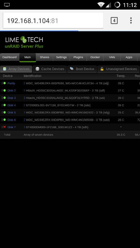

Post a screenshot of your mainpage.
Here is a screenshot. I saw the disk3 errors as well, and when I restated the server I got a green notification about disk3. Although it's had a green ball the whole time.
I think I will just not use the marvel controller to avoid further issues, but hopefully can prevent any data loss.
The marvell virtualization issue usually manifests itself differently, with vt-d enable you can’t see any disks, they don’t usually drop out, but disable vt-d if you can just in case, or better yet and if you have one, use a different controller for now.
