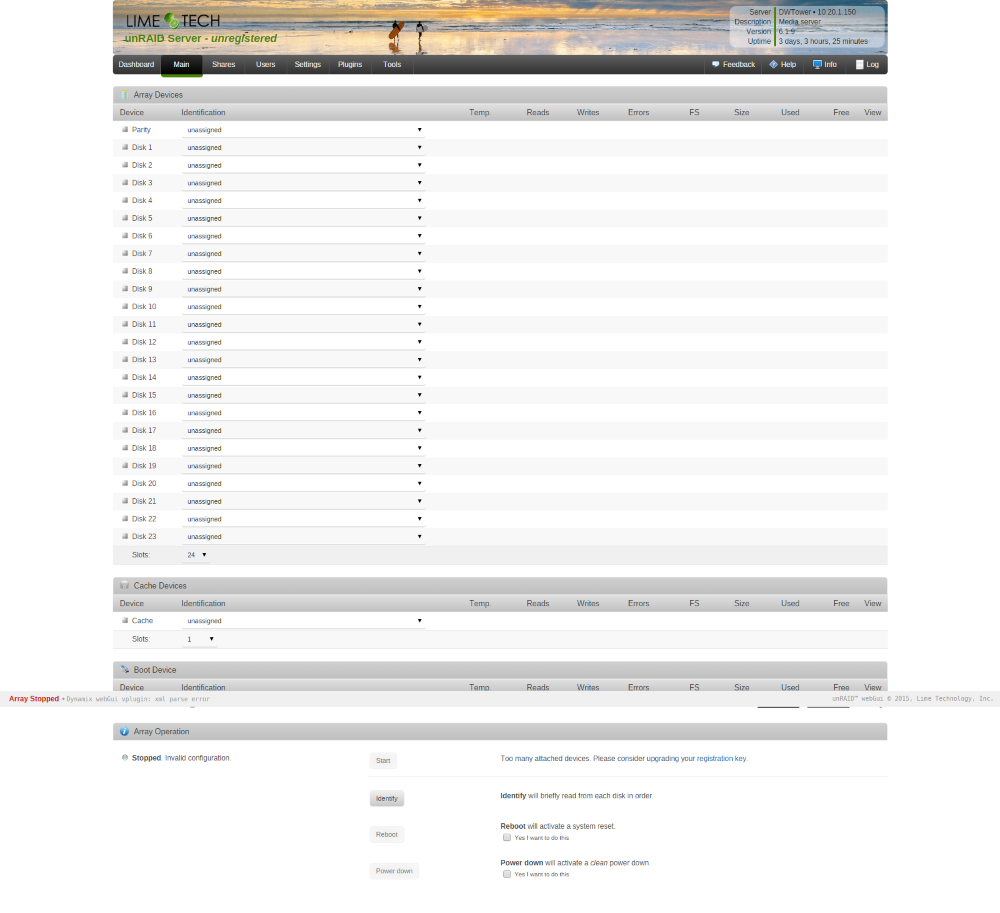

I took the array offline and the drive configuration disappeared.  After reboot, same results. (see attached)
Probably damaged super.dat file, do you have a recent flash drive backup? You should also run chkdsk on a windows pc.

Since I just upgraded a few days ago to v6, I don't have a backup of this drive, however I have the flash drive with v5 on it.

it is not showing up in the drop-down
Just to make sure, power off, check/replace both disk1 cables and power up again, if the disk still doesn't show up it's dead, in that case you can try a rebuild but since the parity probably has issues it's not ideal.
OK, so I ran a chkdsk on the usb boot disk -- no errors
I re-seated all cables and drives and booted back up the system.  Now, I show Disk1 in the drop-down list, even though all the devices are still unassigned.
