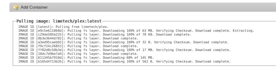

Little update on my post: changing the mtu via gui didn´t work. Still hanging during poll. I attached a screenshot. Is it correct to Change the mtu via webgui? Thanks for your advise!

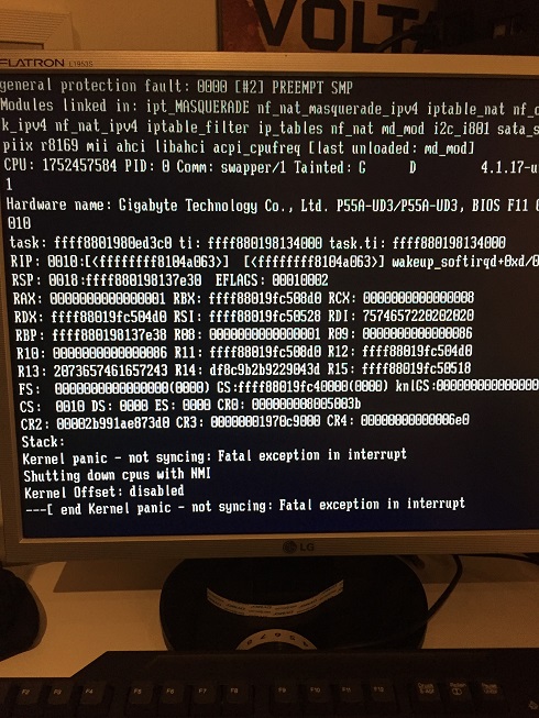

Next update: showing KERNEL PANIC while downloading end extracting...
Maybe Hardware issues...
Bjoernwk:  Yeah yours is a different issue.  For the MTU issue it didn't even get that far and complained about getting a time-out before downloading anything.  Your error messages shows you were able to download stuff, but something else is breaking for you.
And yes, the MTU is changed in the Network settings in the WebUI, but probably won't help in your case.
jedimstr: you are so right. In this moment I changend the ram dimms and guess what... It works. Seems as if one of the two dimms are defect.
So no doubt, Hardware related. Thanks a lot for your time!
