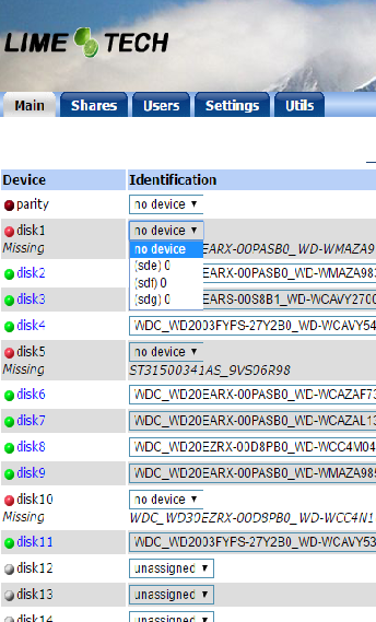

Now I am a bit concerned.  I took a look at one of the "no device" drives and put it in my windows desktop machine.  I was able to use diskinternals linux reader to see the files on the drive were intact.  I put the drive back in my unraid system...and still it shows up as "no device".  If I hover over the "no device" menu, I see there are sde, sdf, and sdg drives in that drop down.  I can't select them though so I am wondering what my next step should be.  I don't want to do anything rash and trash the data on my drives...but I would like to get things restored to a point where I can bring the array online again.  I also wish I was using the current unraid software too, but I took a "if it isn't broke...don't mess with it" approach.  I don't think I should upgrade till I get things working again.

This part isn't clear
Post a screenshot showing what you mean here.
This was a bit difficult to describe.  The img is hopefully attached.
ack, I thought I attached it to the first post!  I did try moving one of the problem drives to a different sata slot but it had no effect.
