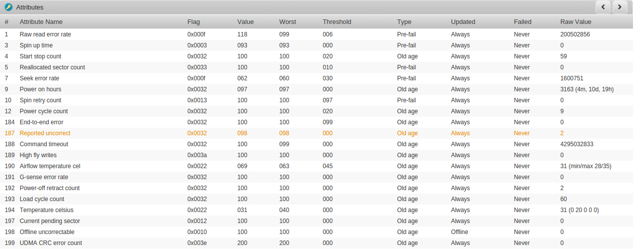

I still have the reported uncorrectable value as a warning (value = 098, raw value = 2)
And the unRaid status mails still say the array has failed (same message as in my earlier post)

I've attached the new SMART report.
ST4000VN000-1H4168_Z304DKYE-20160612-2228.txt

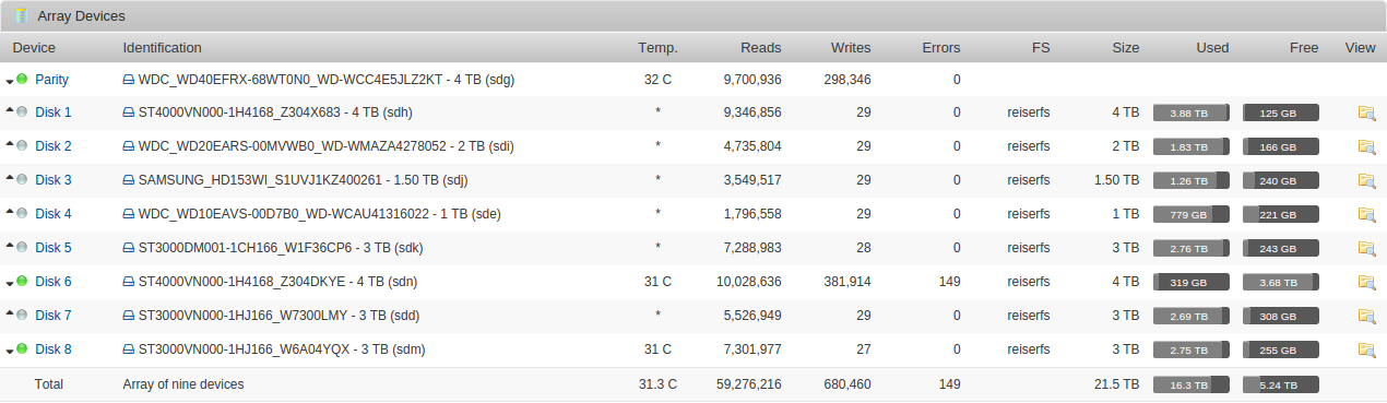

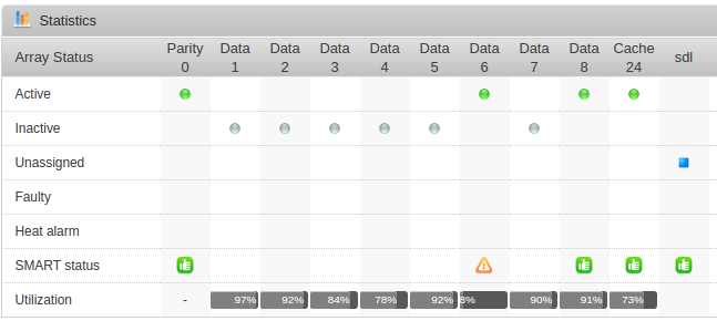

Post a screenshot of the array or the complete diagnostics.
Statistics from the dashboard
Rebooting will take care of the array errors, but I still wouldn't trust that disk, you should have no problem with the RMA even if SMART is ok, if the refurbished disk is any more reliable is another matter, in my experience they have at best a 50/50 chance of lasting more than a couple of months.
