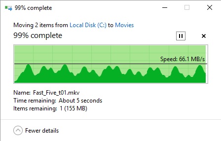

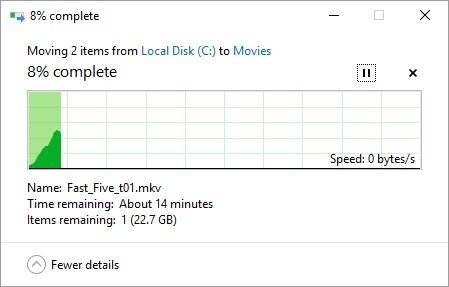

July 15, 201610 yr I'm having a problem that I can't track down. When up loading my files it starts off at about 70MB/s goes for a while and then stops. Waits for a bit at 0 then starts again at full speed. Keeps doing this the entire time. I've tried with and without cache drive. Copying from different drives to unRaid Directly connected my computer to unRaid with two different know good cables One cat5e and one cat6 Enabling and Disabling Jumbo Frames / Setting MTU to 9000 Adjusting rx buffer to 4096 Rebooting everything The only thing that I can find odd is there are some dropped packets but it doesn't look too high. (<.002% if I did my math right) Running the most current stable version 6.1.9. Haven't looked into 6.2. Any ideas? Thanks, Rich tower1-diagnostics-20160715-1627.zip
