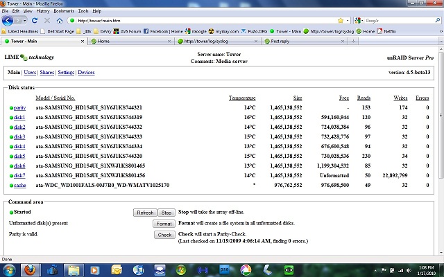

Drive will not mount and shows as unformatted
I have a single drive in my array that s showing as unformatted, but it was formatted just fine yesterday. I added a hot spare drive to the array, just in case. When the system started, it formatted the spare drive and all of the data "appears" to be present, but the drive still shows as unformatted. I am running 4.5 Beta 13 and have attached a syslog.
Any help would be appreciated.  Also, what would cause this type of issue?  I have seen a few other similar posts since this new(er) release.  Does it have something to do with this newer release or do you think it might be hardware related?
Thanks
On last note:  All of the drives appear green.

Sorry, I added to my first post, but I'll explain in more detail.
All the drives showed as green when I checked the system, but one of the drives was showing unformatted and all of the data from that drive seemed to be missing from the share.  When I checked the disk in windows explorer it was not present.  I got a little panicked about this so I stopped the array and added in a spare 1.5T drive that I had sitting in the case.  I brought the array back up and started it.  The first thing it did was to format the new drive and that process did complete successfully.
Now it appears that all of the data is there (although hard to tell exactly), the new drive is online, but the old drive is still showing as unformatted.  Since I am very new to this I have no idea what this means or what to do next. I have attached a screen print from the management console if it will help.

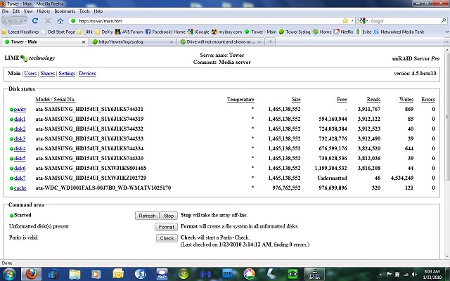

Here is the syslog and a screen image.
The log is stating that disk 7 will not mount and you will see on the screen image the the new drive is showing as unformated.

Based on what has happened now, the "simulated" drive would have also been unformatted... I believe your files in the MyMovies and iTunes shares are on other disks...
Now... do not confuse the physical slot in your rack with the assignment of "disk7" in your "devices" page.
From what you now described, the "reconstructed" disk7 is not formatted, and apparently never was.  Is this true?
