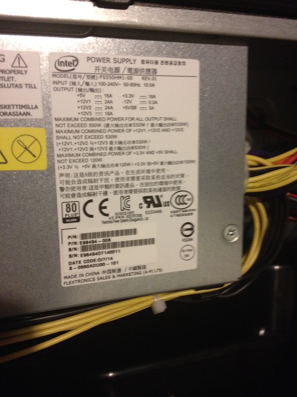

Before I dig through the diagnostics, what can you tell us about your hardware? How many disks? Controllers? If you have more than 5 disks, what is the exact model of your power supply?
Drives:
7 Data (including problem drive)
1 Parity
1 unassigned
1 SSD cache
Motherboard: Intel S2400SC2
All drives are connected to the motherboard, which has 6 SATA ports and 2 miniSAS connectors supporting 4 drives each.  I'm pretty sure the failed drive is on the 2nd miniSAS, which needed a storage activation key (RKSATA8) to function.
The power supply came with the system (Intel P4304SC2SFEN).  It's 550W. I'm attaching a picture of it.  I previously posted that I was concerned about how it would handle my drives, but that was more about a spike during spin-up.
