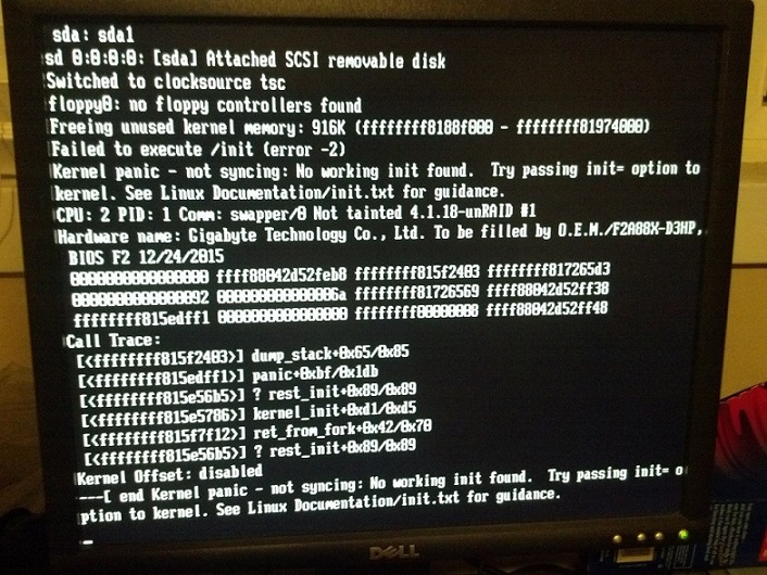

September 16, 201610 yr Author Looking a little harder at the video I made of one of the boot sequences, I think there may also be an error related to the /init. "Failed to execute /init (error -2)" "Kernel panic - not syncing: no working init found. Try passing init= option to kernel. See Linux Documentation/init.txt for more information" Anyway thanks for reading... Sully
September 18, 201610 yr Author Have tried several more things to resolve this issue, so I can boot into UnRAID. 1. I've changed the UEFI BIOS Setting for the Flash Drive from UEFI to Legacy (the old board wasn't UEFI). 2. I've added the remaining hardware from the old machine (4 SYBA x4 SATA 3 Expansion Cards) and connected the Backplanes w/the 3TB Drive installed. After completing #1, I still got the Kernel Panic message with the Init issues. After completing #2, I didn't see any change in behavior. Here's a pic of the end result (where the system hangs)... Looking for some advice... At this point, I'd even accept someone telling me I'm a Muppet and should be able to figure this out on my own. Thanks! Sully.
