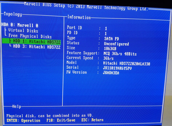

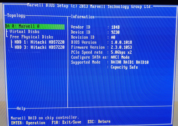

October 16, 201610 yr Author Ok, I have made a little progress. If I use the 4th PCIe slot (the short one) then the controller card does show up in post. I managed to open the setup menu and you can see the options attached. However I am not sure what to do as I obviously don't want to wipe anything. I am now wondering if unRaid needs a driver for these cards? Not sure why as I am using the exact same YSB stick that worked on my old motherboard and have changed nothing to the unraid install (6.17). The Syslog is attached and does show some warnings but it doesn't mean anything to me unfortunately. Thanks again for any assistance! Adam server-diagnostics-20161015-2250.zip
October 16, 201610 yr Author Ok so when in doubt update stuff. I updated unRaid to 6.2.1 and voila, unRaid now recognises one of my PCIe contollers in the mini slot. I moved my 4 channel cart to that port and moved a few drives round in the array and now have it running albeit without all of my drive bays working as I am still short a few sata channels. I am going thinking of updating the Motherboard bios to see if that helps with the other PCIe slots that just won't recognise any controller cards but will wait for some feedback in case you guys have some better suggestions. Cheers, Adam
