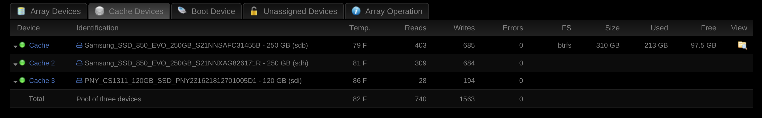

So I just ended up going to the cache tab and adding the 120Gb ssd to the 2 250Gb.
Now it created a pool of 310Gb. but I want to get the drive out. When I remove it, it freaks out.
When I connect to the share, it still says its only 250Gb.
I haven't balanced it the pool or anything.
I just want to know how to remove it before I screw it up more and lose the data.
I just want the drive back out of the "pool" and the orginal 2 250 back in RAID1.

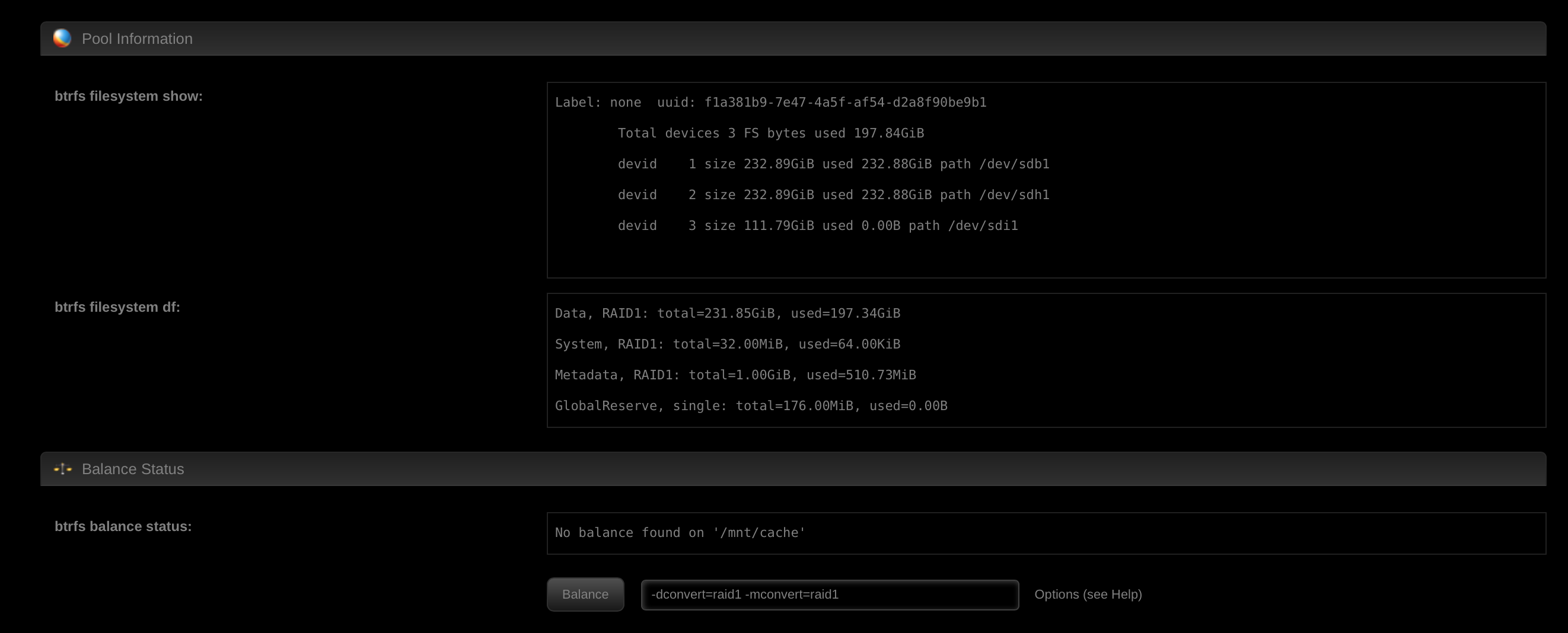

I go to the 1 cache drive, on that page it says this.
No balance found on '/mnt/cache'
I clicked balance and in the syslog it prints
Oct 29 11:49:48 MediaServer php: /usr/local/emhttp/plugins/dynamix/scripts/btrfs_balance 'start' '/mnt/cache' '-dconvert=raid1 -mconvert=raid1'
I don't know if that worked or not, if it's in the process of balancing or what.
