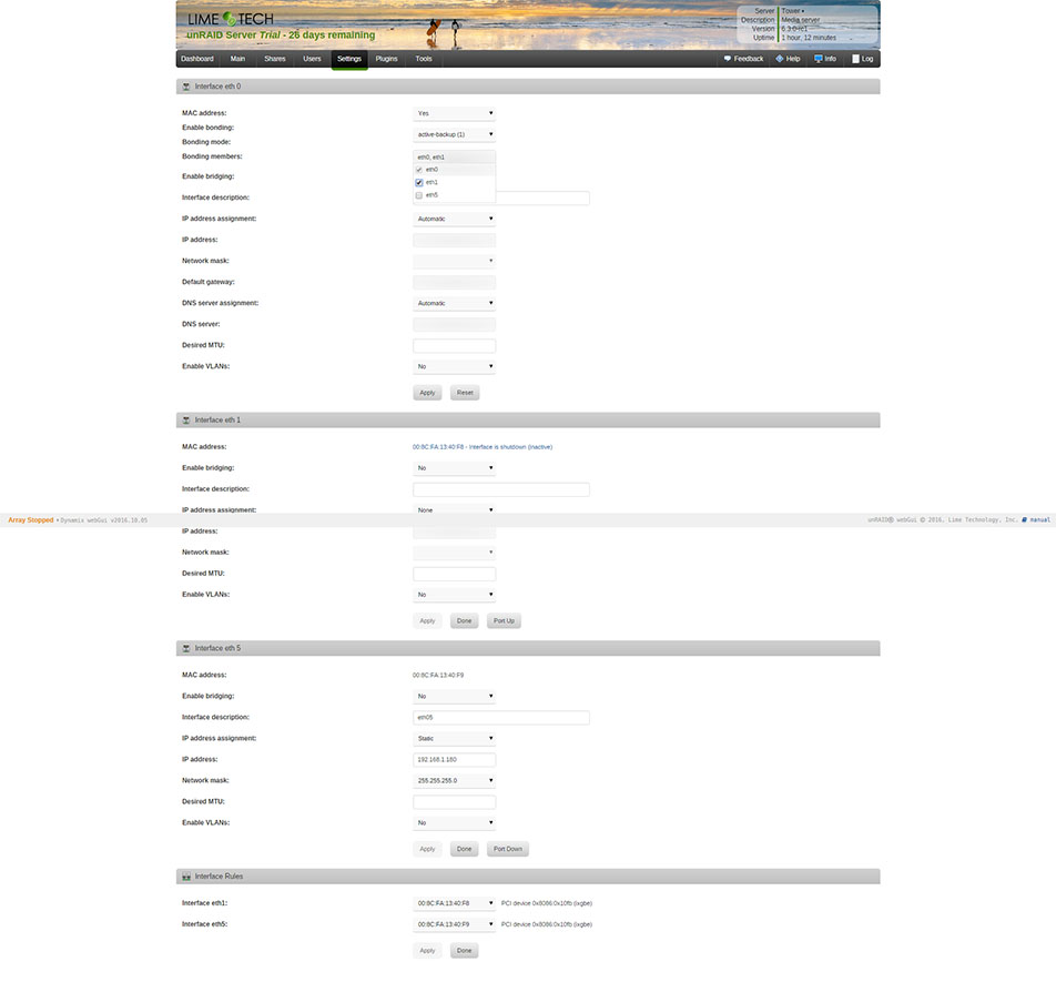

October 29, 201610 yr Hello all, I am sorry if this is dumb question but I am new to this and I have not been able to find my answer through standard searches. The back story: New enterprise grade server bought used off ebay. Two SFP ports only, no room for PCI NIC without removing raid card. SFP to RJ45 ordered and waiting to receive. While waiting, I removed raid card, installed 4 port Ethernet card to install and "play" with unraid.. Got sfp to rj45, sfp port now works. removed 4 port PCI card. Now I have an issue where unraid keeps repeating, "Device 'eth0' does not exist". I go into network settings, and I cant remove eth0 and just use eth1 & eth5. How do I fix this?
October 29, 201610 yr Delete your /boot/config/network.cfg file (i.e. the network.cfg file in the config folder on your flash device) and reboot.
October 29, 201610 yr Try after shutting down, deleting from the flash drive the 2 network files in /config (network.cfg and network-rules.cfg), then reboot (or delete the rules file and edit network.cfg). edit: I see John beat me!
October 29, 201610 yr Author did that with no change edit, I didnt mess with the second file, let me try that too...
