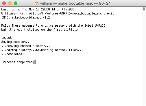

I'm having a similar problem on mac. I just keep getting "FAIL: There appears to a drive present with the label UNRAID
but it's not installed on the first partition"
I've included a screenshot and any help would be amazing.
William

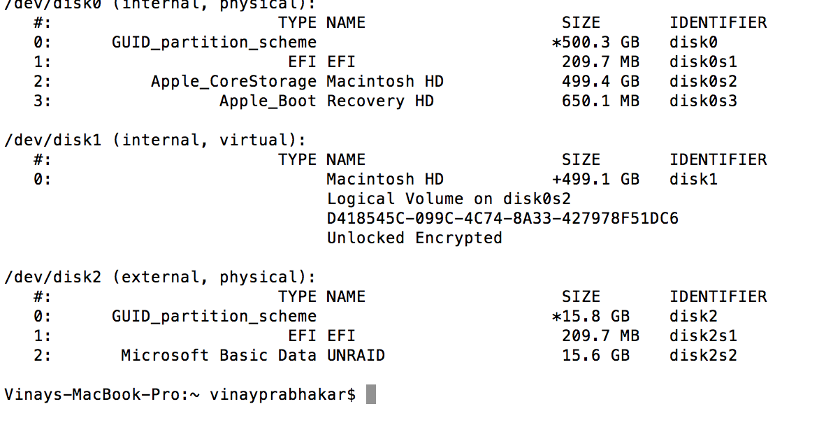

Please (re)attach your unRAID flash back up to you Mac, open Terminal, run 'diskutil list' and copy the output from that command here so I can review.
Facing the same issue..
/dev/disk0 (internal, physical):
  #:                      TYPE NAME                    SIZE      IDENTIFIER
  0:      GUID_partition_scheme                        *500.3 GB  disk0
  1:                        EFI EFI                    209.7 MB  disk0s1
  2:          Apple_CoreStorage Macintosh HD            499.4 GB  disk0s2
  3:                Apple_Boot Recovery HD            650.1 MB  disk0s3
/dev/disk1 (internal, virtual):
  0:                            Macintosh HD          +499.1 GB  disk1
                                Logical Volume on disk0s2
                                D418545C-099C-4C74-8A33-427978F51DC6
                                Unlocked Encrypted
/dev/disk2 (external, physical):
  0:      GUID_partition_scheme                        *15.8 GB    disk2
  1:                        EFI EFI                    209.7 MB  disk2s1
  2:      Microsoft Basic Data UNRAID                  15.6 GB    disk2s2
You need to recreate the partition table for the USB drive to MBR, not GPT. You'll also lose all the data on the drive in the process, so you'll have to copy the archive contents over again.
