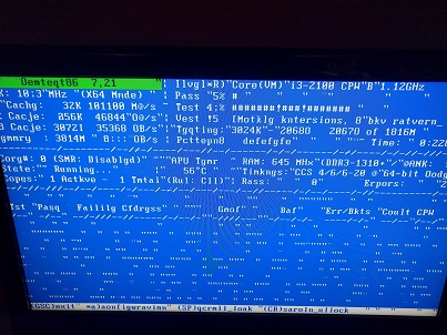

Weird characters on screen during memtest(also occurs during boot/while running)

Seems like the problem comes from somewhere else. During rebuilding my 'missing' drive I all of a sudden couldn't connect anymore to the GUI, nor ping my server. When I went upstairs to check it out I had all kinds of garbage-characters filling up my VGA-attached screen.
I now moved the system downstairs again and attached it to a HDMI-screen. It boots like normal so I decided to run a memory test. I tried it multiple times but each time after a few minutes it gives me a screen like the attached screenshot.

I'm afraid you have a serious hardware issue.  That's a really interesting display there!  Something is flipping the 2 bit on, which turns spaces into quotes, and adds 2 to many letters.  Since it got to Test #4 without reporting a memory error, in an obvious memory corruption scenario, I think it's not a memory issue but a bus or register issue.  That means motherboard or CPU.  Could also be a heat issue.  Overheating chips can be very flaky, but I would have hoped the system had shut down before now.  I suppose I should mention bad power as a remotely possible suspect, but this doesn't look like it to me (but I could be wrong).  You are going to have to swap out major components, until it all just works, including a Memtest.  Personally I think it's the motherboard, and you may want to check for bulging caps on it.
