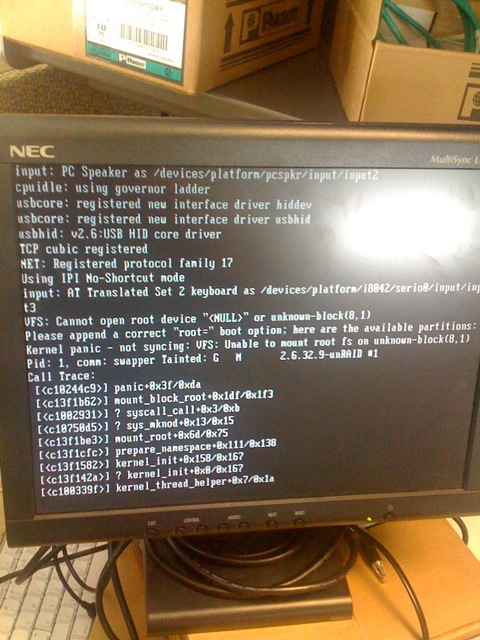

I am currently testing unraid with a D865GLC motherboard and my machine keeps rebooting after several minutes.
I have reformatted the usb stick twice now and still have the same problem. There are no add ons currently on the system and I am at a loss. I tried to tail the syslog, but nothing useful is writing. I have attached a screen shot from my phone, sorry for the quality.
Any help would be greatly appreciated.
Thanks!
Joe

Edit4: My bzimage was corrupted. I discovered this when upgrading to 4.5.3, when I tried to copy over the bzimage file, it couldn't access the file. Chkdsk fixed it, updated to 4.5.3, now it hangs on kernel_thread_helper, same as OP! At least we have the same problem, very similar motherboard.

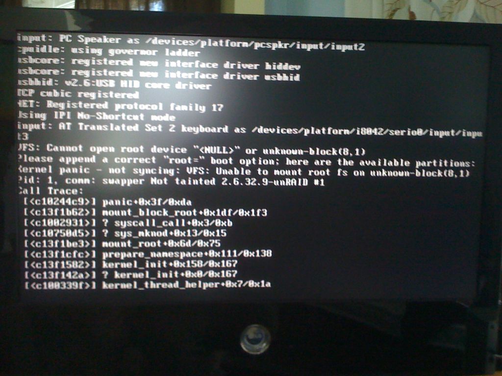

I came home today and found my unraid server powered off. No idea how that happened. Booted it up and it was stuck on boot, hung up on kernel_thread_helper, same as before.
I deleted the bzimage and bzroot, re-copied the files to the USB stick, and now it's all working fine again!
