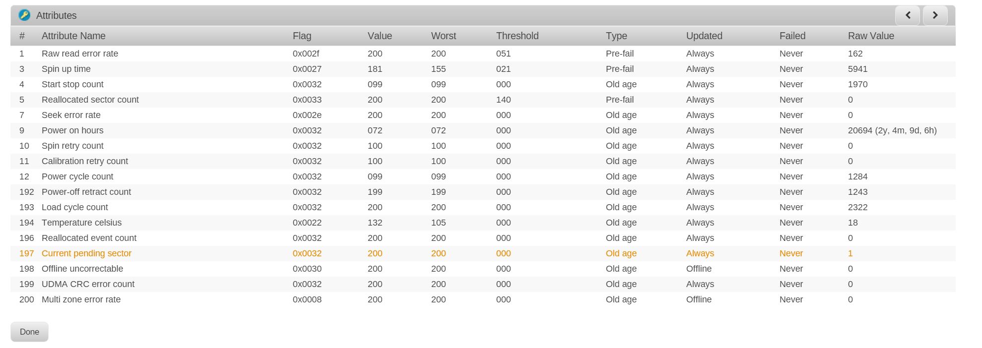

Fast forward to present day, I upgraded unRAID to 6.2.4 and upgraded all hardware, but am still using the same disks.  Things seem to be running fine.  I'm just not sure what to make of disk 2.  I think I am reading the SMART results correctly.  The values look good to me.  I also executed both the short and extended SMART self tests and both passed without error.  Thoughts?
tower-smart-20170129-2233.zip
You have one pending sector.
Basically this means that the disk has determined that this sector is bad, but it cannot take that sector of service because it may contain valuable user data. It doesn't know and won't ever take it out of service based on a read error - even a read error that is so bad that it will never succeed. If that sector were ever to be written to, it would give the drive an opportunity to "remap" a spare sector to replace the bad sector, and take the bad sector out of service, all without risking the loss of user data. (This is the magic of the SMART system). Parity checks that do no writing do not afford the ability to do the remapping.
It looks from your smart log that this sector may have been causing mischief for quite some time. (look for "Error: UNC 8 sectors at LBA = 0x0000f330 = 62256" in the smart report)
There are a couple of options to get this to clear, including replacing and preclearing the disk.
If all other disks in the array appear good, you could "rebuild" this disk with the pending sector, similar to the procedure used to rebuild a disk that was kicked from an array due to a bad or loose cable. The rebuild would write to each and every sector on the disk, and should provlde the disk the opportunity to take corrective action.
I will note that a good disk will never develop a bad or pending sector, and although sometimes a procedure like I mention above will resolve the issue and allow the drive to stay in service for a period of time, my experience is that one a drive starts to act up, its days are numbered. But that should not deter you from trying to fix it. Just keep an eye on the drive.

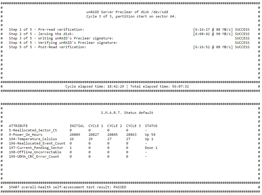

Thanks for your support guys.  I unassigned disk2 and ran it through 3 preclear cycles.  It looks to have corrected the pending sector; results attached.  I am about to add it back to the array and let it rebuild from parity.  Is it possible to format XFS before rebuilding?  The format option is greyed out.
Format means "write an empty filesystem to this disk". That is what it has always meant in every operating system you have ever used. unRAID treats this write just like any other, by updating parity so that it agrees that the disk has an empty filesystem on it. Obviously not what you want when trying to rebuild a disk that had files on it.
