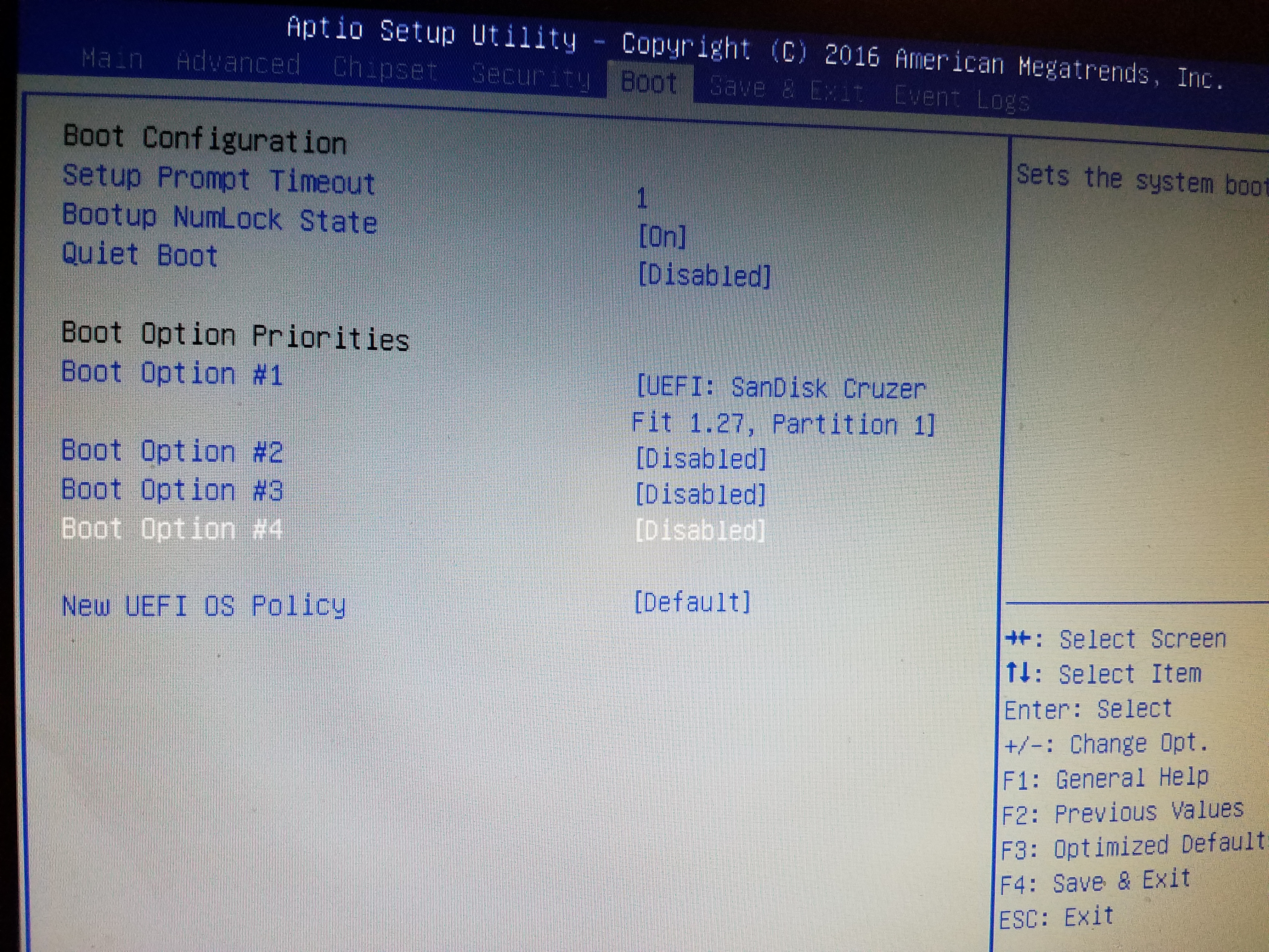

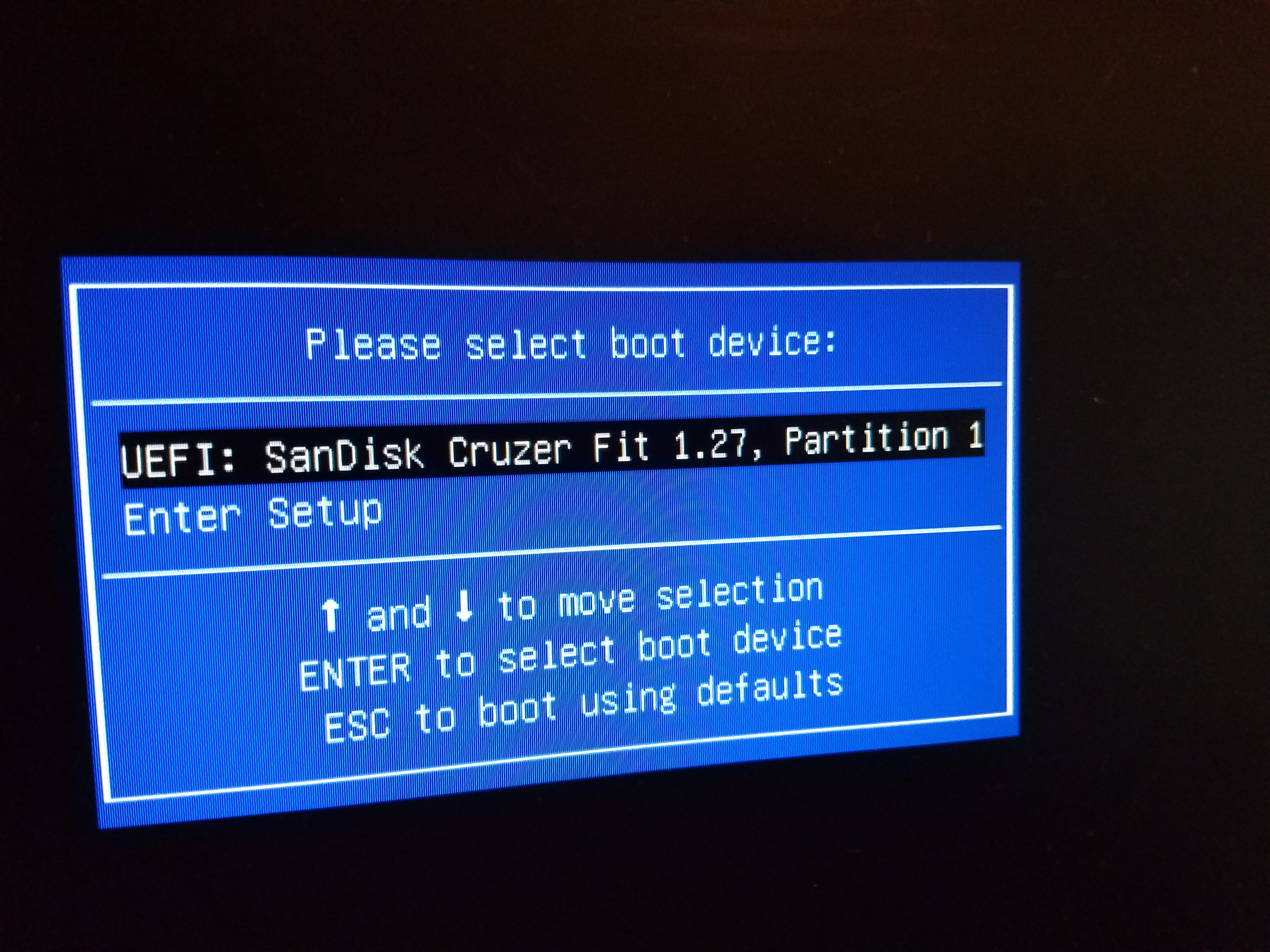

  • On the ML10 Gen9 I've tried the follow (after I've set boot priority to USB)...I'm also manually selecting the USB from the boot menu
    • I/O USB port on the motherboard
    • External (Rear) USB
    • Turned off Quick Boot

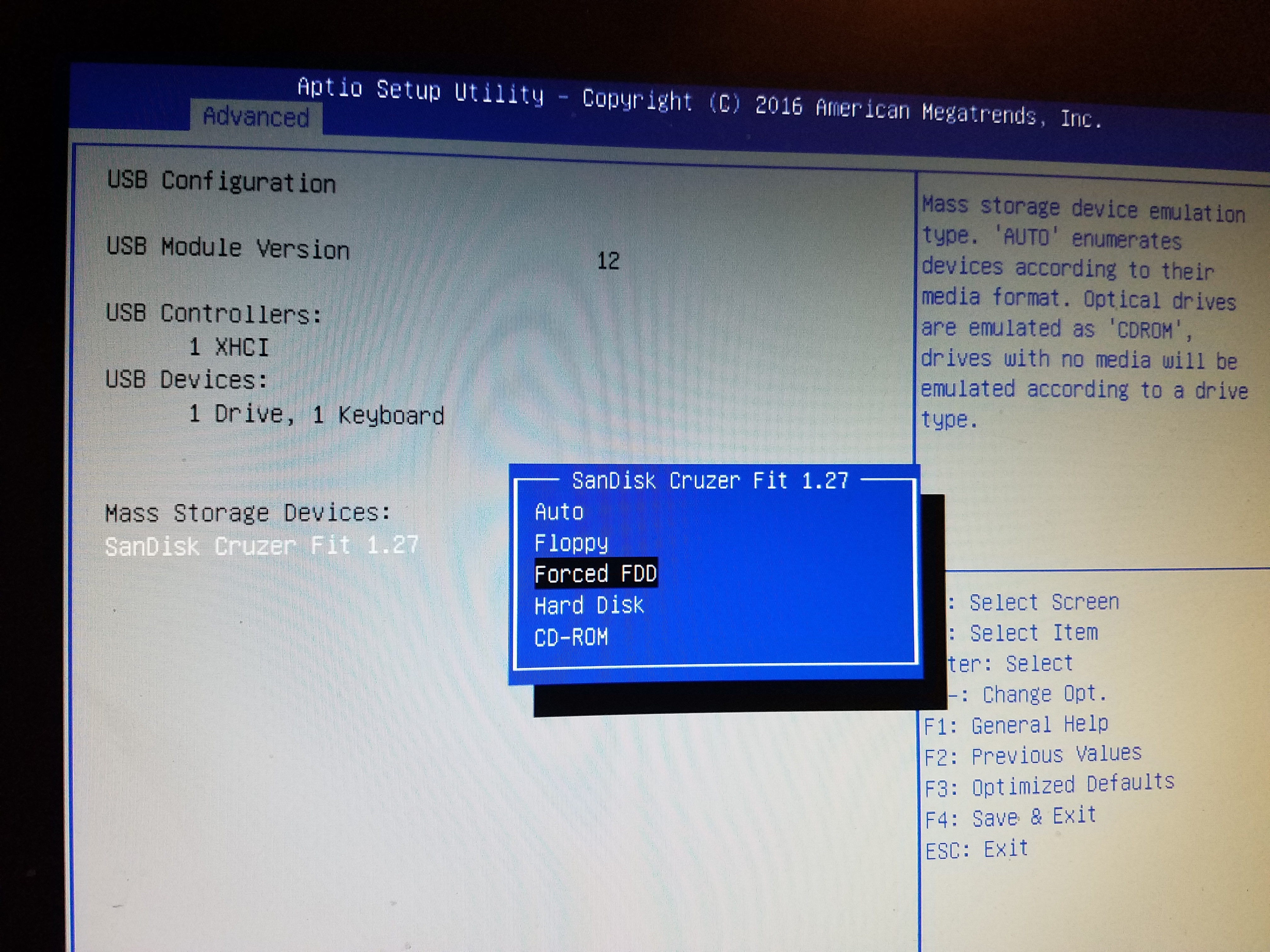

    • Set USB to Force FDD
    • Set USB to Force HDD
    • I've tried the above with BOTH of the USBs...with no success

Turn off UEFI (secure boot), unraid only boots legacy mode.
Don't you love it when you look at something for an hour...then someone else spots the issue in 10 seconds...ugh. I knew it was going to be something obvious.
Thanks jonathanm, I'm up and running now with a couple of drives preclearing.
