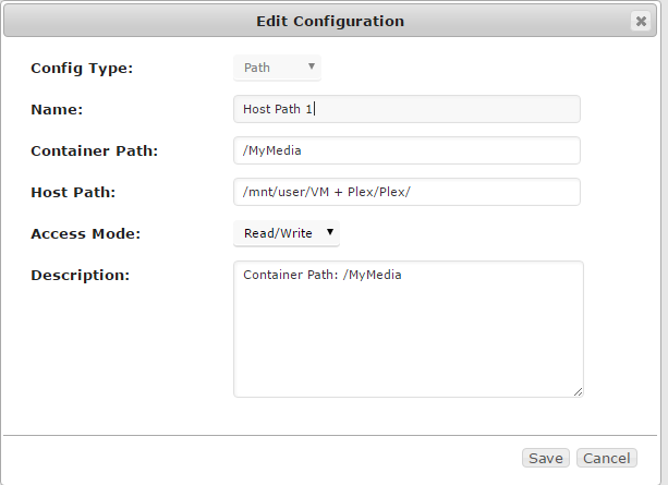

Hit edit on host path 1 and post that screenshot. But if everything is ok you tell plex all your files are in /MyMedia

In the youtube clip it showed to make a/MyMedia directory, that is why that is there but I would like it to show the media that is on the drive /VM + Plex/Plex

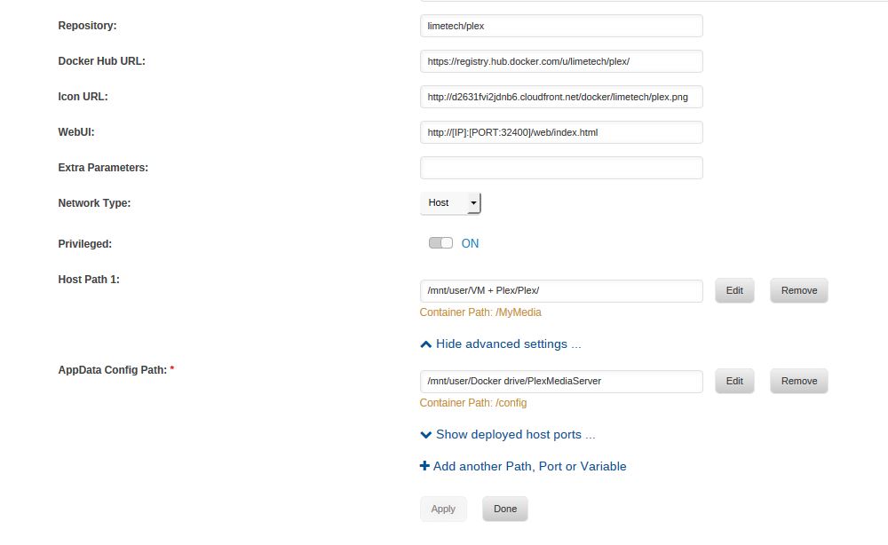

Here is the screenshot!
Assuming that you have a share named VM + Plex with a subfolder named Plex that contains your media files, you tell Plex to add your libraries from /MyMedia
I have got that configuration but the media is not being detected, lots of file formats are in there too
I think you both may be slightly talking on different topics, or aspects without realizing it.   So yes, as Squid said, "Assuming that you have a share named VM + Plex with a subfolder named Plex that contains your media files, you tell Plex to add your libraries from /MyMedia"
I might have said it differently, such as; as long as the mount point VM + Plex exists in your Linux environment, with a sub-directory named Plex that contains your media files, you tell Plex to add your libraries from /MyMedia

jjackstar, I played with plex about a month ago under docker.  I was at first seeming to have the problems you seem to be describing.  I thought I was doing things correctly, but no worky...
 Then I put my mind back in to very basic LINUX mode.  I looked at the configuration settings, and it dawned on me... "good grief!  I am linking to a mount point that I have never set up so it does not exist!"  So I actually created a mount point to match what I was setting up in the PLEX docker configuration, and IT WORKED! I then played with setting up various mount points that were actually other computer resources on my network, and they also proper worked and could be added to the PLEX docker server libraries!
