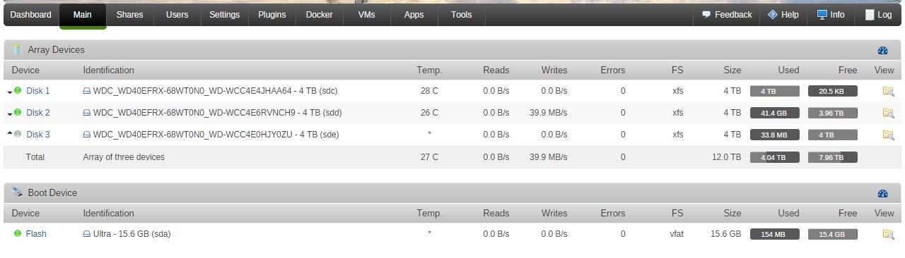

I'm running user shares, and was about to transfer all my data back to may disks.

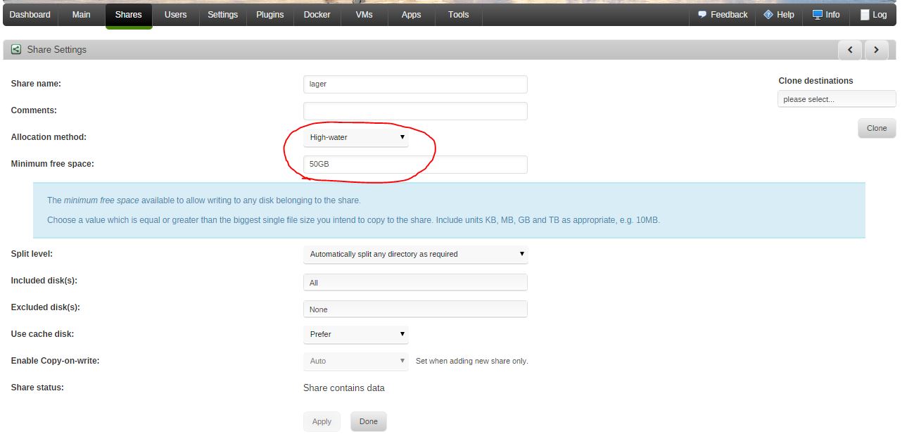

It is running High water, with a 50G minimum space, as seen on the first picture(shares)
Yet as the first disk was filled, suddenly my VM stopped and it stopped downloading my data, it doesn't seem to split the data at all ?

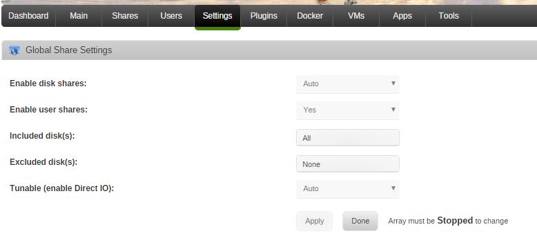

Check included and excluded disks both for the share and in the global share settings, if you can't find the problem post your diags.
All disks are included in all settings, and none is excluded.

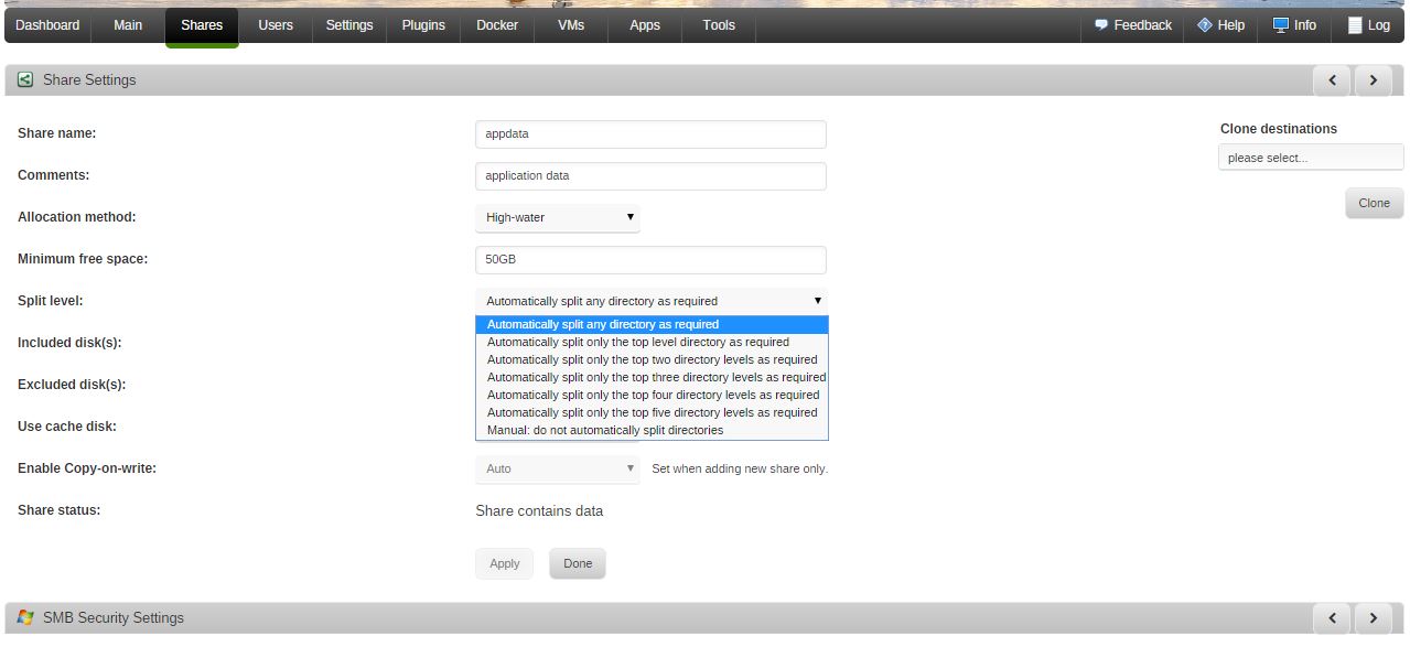

You have shares with split level 1, split level overrides included disks.
I'm not sure what split level 1 translates to in Unraid Gui ?
I've change all my shares to "autoamtically split any directory as required"
To me that sounds to be the correct in order to have Unraid auto fill the disks ?
That's not what your diags show, can't say the full name of the shares because it's anonymized but these 3 are split level 1 (split top level only):
a-----a
d------s
s-------m
Yeah those I changed to the above( split any)
