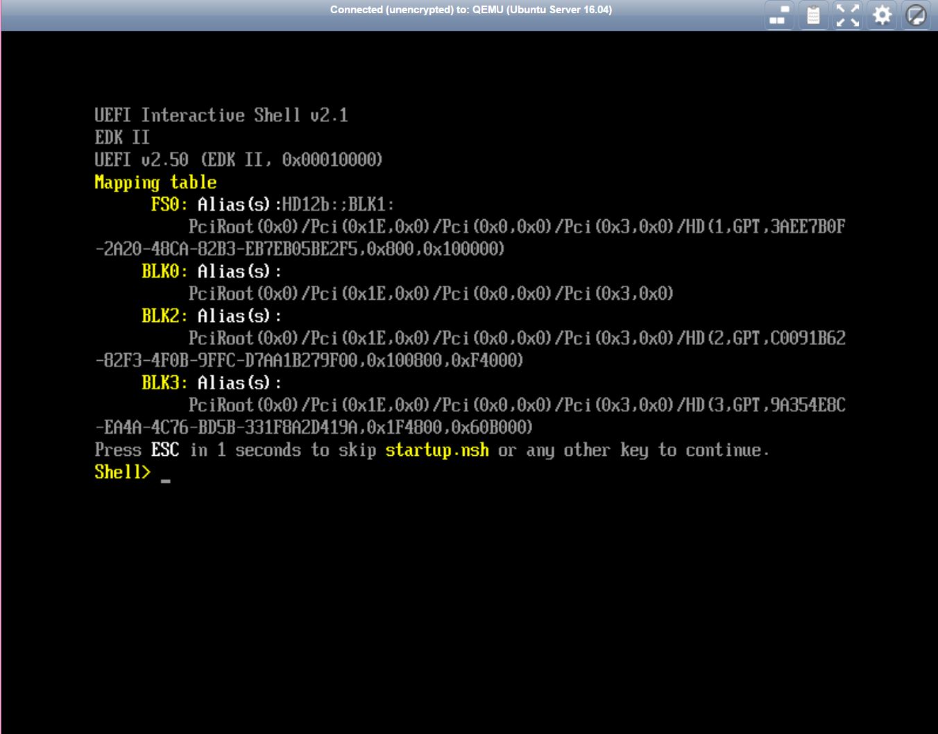

I ran the installer just fine and upon reboot I get the attached screen shot: UEFI Interactive shell.
I selected "linux" as the VM type. I went through the installer the same way I've done on my bare metal Ubuntu Server 16.04 installs.
Don't know where I am going wrong.
Thanks for any help!

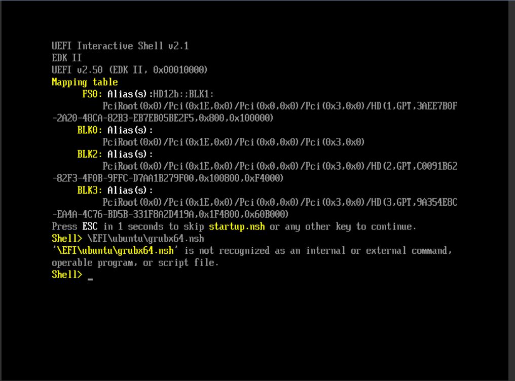

FYI:
Read this might be a solution:
Shell> fs0:
edit startup.nsh
\EFI\ubuntu\grubx64.efi
ctrl-s <cr>
<enter>
ctrl-q <cr>
reset
Tried it, but got the attached
Anyone out there have any ideas?!
either use seabios instead of ovmf
or
click the restart command/button on the VNC window, and when the bios loads, go in it an select your startup disc from there and see if it will persist after reboot.
