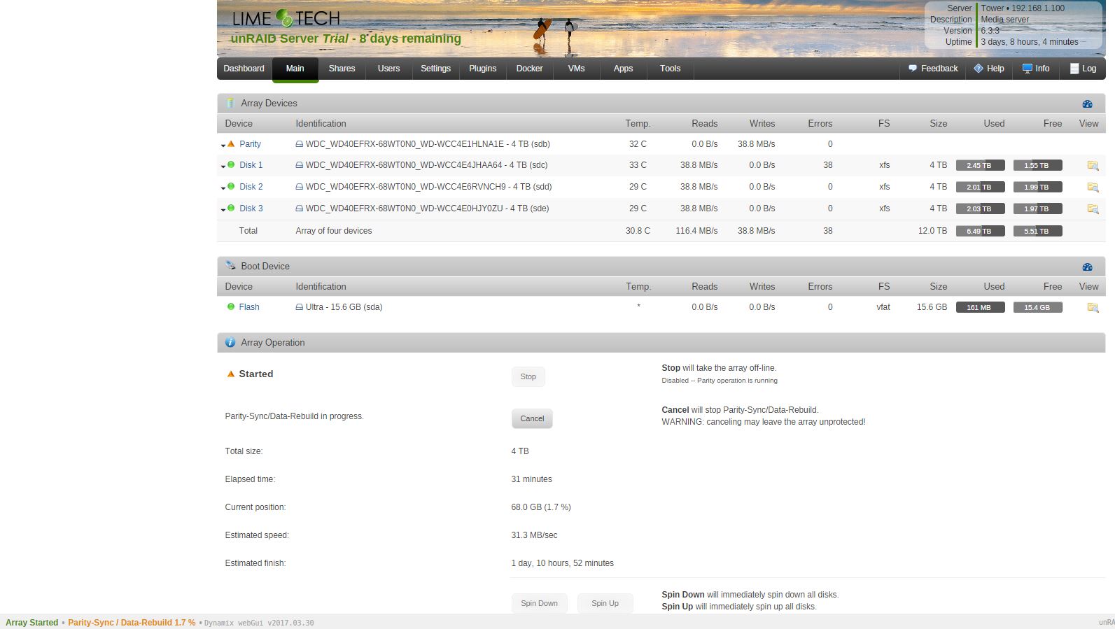

Parity-Sync/Data-Rebuild speed ?
I've just added my parity drive to my array, but I think it is lacking ALOT in speed.
I'm seeing reads and writes speed about 37-40 mb/s.
Is this normal speed or do I have a serious speed problem ?

As for the low speed, I know HP Microservers have a write cache setting in the bios (disable by default) that's gives similar write speed, speeds become normal when it's enable.

As for the Write Cache, you are a GOD sent Johnnie, didn't know I had messed with it, but apparently I had, because now i'm seeing read and write speeds in the range of about 155-160mb/s on my WD Reds.
