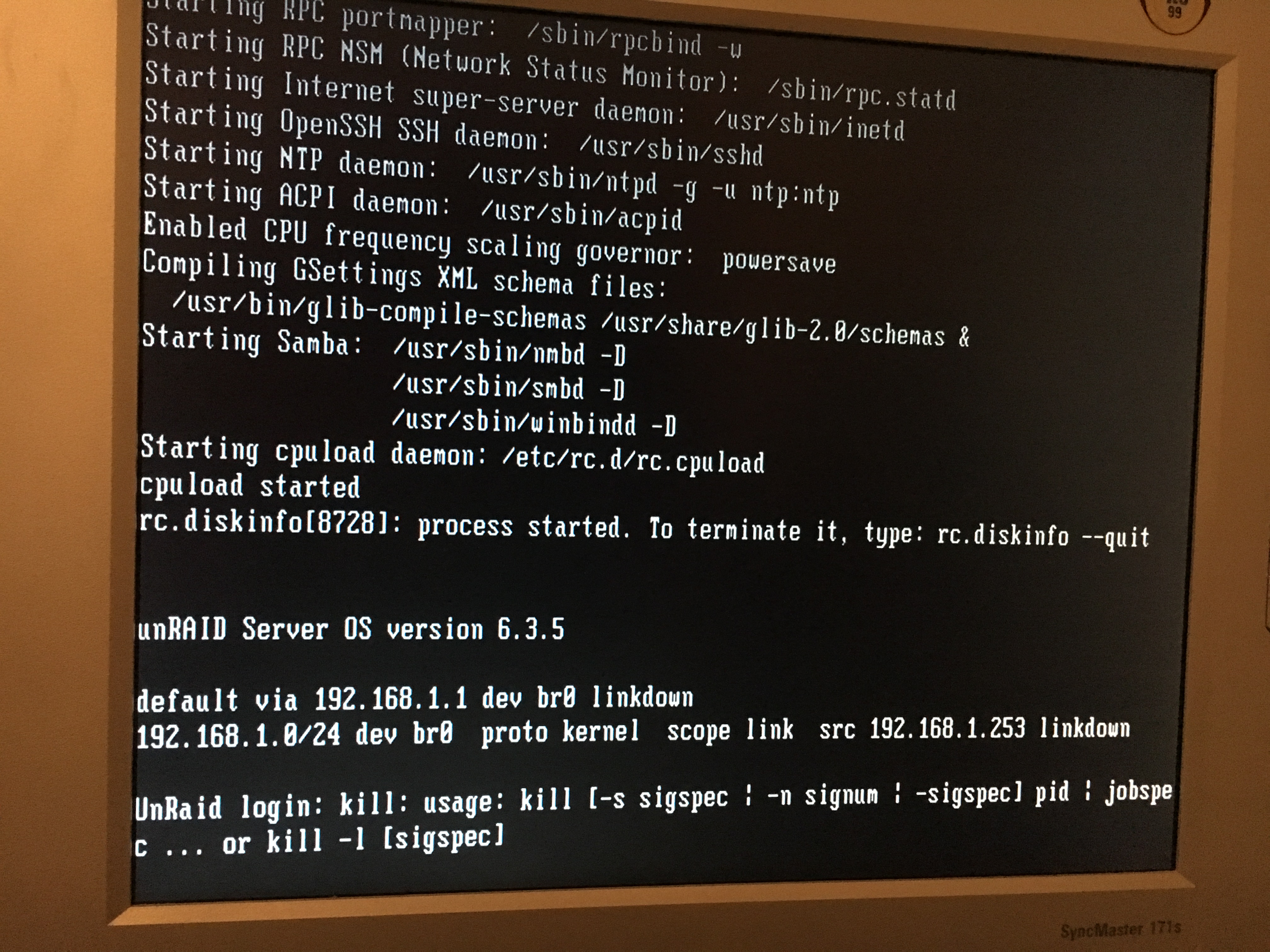

I still have regular crashes with my HP ML10 Gen9 Server. Approx. every 5 to 8 days the server as well as AMT is not responding anymore. In the past I had also additional RAM installed and a Quad-Gigabit-Networkcard. I have removed those two parts but it is still happening.
Finally I was able to connect a Monitor and Keyboard to the Server and today, when the server crashed again, I was able to make a screenshot. Btw. There  is no input response from the keyboard.
Is this Screenshot helpfull? Could it be related to Unraid and or Hardware?
