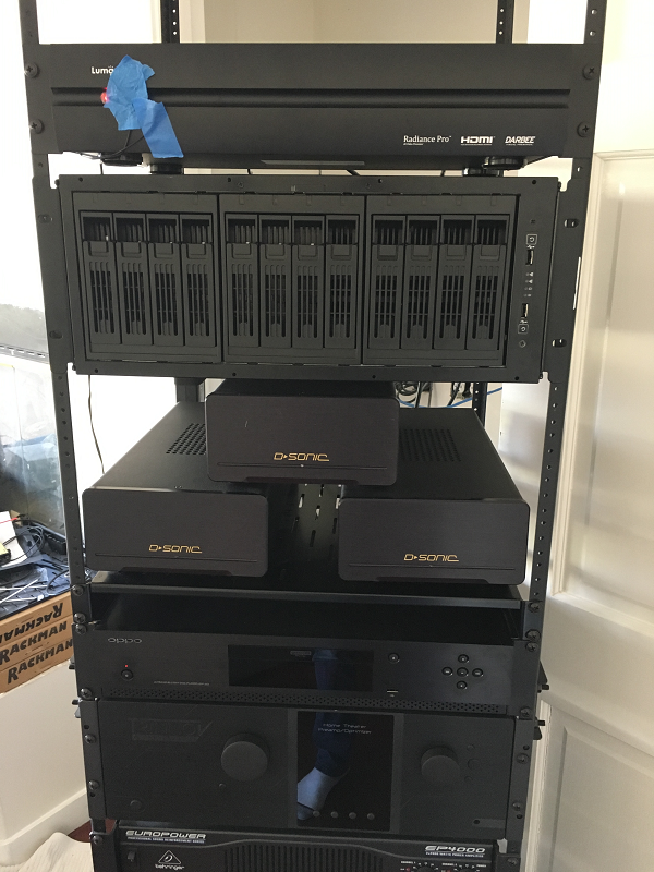

August 2, 20179 yr I'm not a gamer either and doing almost the identical thing for my home theater. I'm running bitstreaming audio out of my GPU to a Trinnov 16 channel into a 9.6.1 Atmos surround system and the video to a JVC RS600 projector using MPC-BE and madVR at max settings. Doing this with Windows 10 VM on unRAID Server. To be honest, I'm not sure I would have attempted this without @gridrunner 's excellent videos. Edited August 2, 20179 yr by mikela
