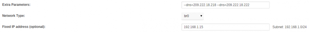

August 2, 20179 yr I'm still trying to work through this and please excuse my ignorance as I am learning as I go. I also did not want to hijack another thread. @bonienl since you seem to be dialed into this stuff. I want my SAB and Deluge containers to be tunneled through my VPN provider using firewall rules/aliases in pfsense. Right now I use the Pipework container to handle the static IP assignment and use the Extra Parameters fields in the container to assign static DNS entries (--dns=xx.xx.xx.xx). I am trying to move away from this and and retire my Pipework container. I have edited my Deluge container as shown below: However, the DNS entries are not sticking... root@UNRAID:~# docker exec -ti Deluge /bin/bash root@663c25303022:/$ cat /etc/resolv.conf nameserver 127.0.0.11 options ndots:0 As a reference, this is what I see in the resolv.conf for my SAB container which is still using the Pipework container. root@UNRAID:~# docker exec -ti SABnzbd /bin/bash root@e8fe4bb265ba:/# cat /etc/resolv.conf nameserver 209.222.18.218 nameserver 209.222.18.222 Do I need to create a new custom network instead of using br0? Also, the piece the I don't know how to configure (and honestly don't even know if it will help) is the --dns-opt= parameter. I haven't had much luck finding good documentation on what exactly the options are. Other than the DNS snafu, the good news is that I am able to reach the Deluge webui. The bad news is that Sonarr is not able to reach the Deluge container using the same IP/Port. TIA for any help! John Edited August 2, 20179 yr by johnodon
August 2, 20179 yr This is from the docker documentation regarding DNS in custom networks, which óperates differently from the standard 'bridge'network. --dns=[IP_ADDRESS...] The IP addresses passed via the --dns option is used by the embedded DNS server to forward the DNS query if embedded DNS server is unable to resolve a name resolution request from the containers. These --dns IP addresses are managed by the embedded DNS server and will not be updated in the container's /etc/resolv.conf file. --dns-opt=OPTION... Sets the options used by DNS resolvers. These options are managed by the embedded DNS server and will not be updated in the container's /etc/resolv.conffile. See documentation for resolv.conf for a list of valid options The embedded DNS server uses address 127.0.0.11 Edited August 2, 20179 yr by bonienl
August 2, 20179 yr Author OK...so while using the --dns=xx.xx.xx.xx Extra Parameter does not modify the resolv.conf within the container, it does appear that the container is using the entries. I am using this method to test for DNS leaks: https://www.privateinternetaccess.com/forum/discussion/23924/easy-quick-dns-and-ipv6-leak-testing-via-command-prompt-line-method-no-browser-or-website-needed If I do not set DNS entries in the Extra Parameters, my public IP is exposed when I perform an nslookup as described above. (I replaced my public IP with xx.xx.xx.xx) root@fff1d16a37d1:/$ nslookup whoami.fluffcomputing.com nslookup: can't resolve '(null)': Name does not resolve Name: whoami.fluffcomputing.com Address 1: xx.xx.xx.xx xx-xx-xx-xx.rest.of.fqdn If I include my VPN's DNS entries in Extra Parameters, my VPN IP is returned (replaced with yy.yy.yy.yy): root@154df63b5b93:/$ nslookup whoami.fluffcomputing.com nslookup: can't resolve '(null)': Name does not resolve Name: whoami.fluffcomputing.com Address 1: yy.yy.yy.yy ip-yy-yy-yy-yy.rest.of.fqdn
