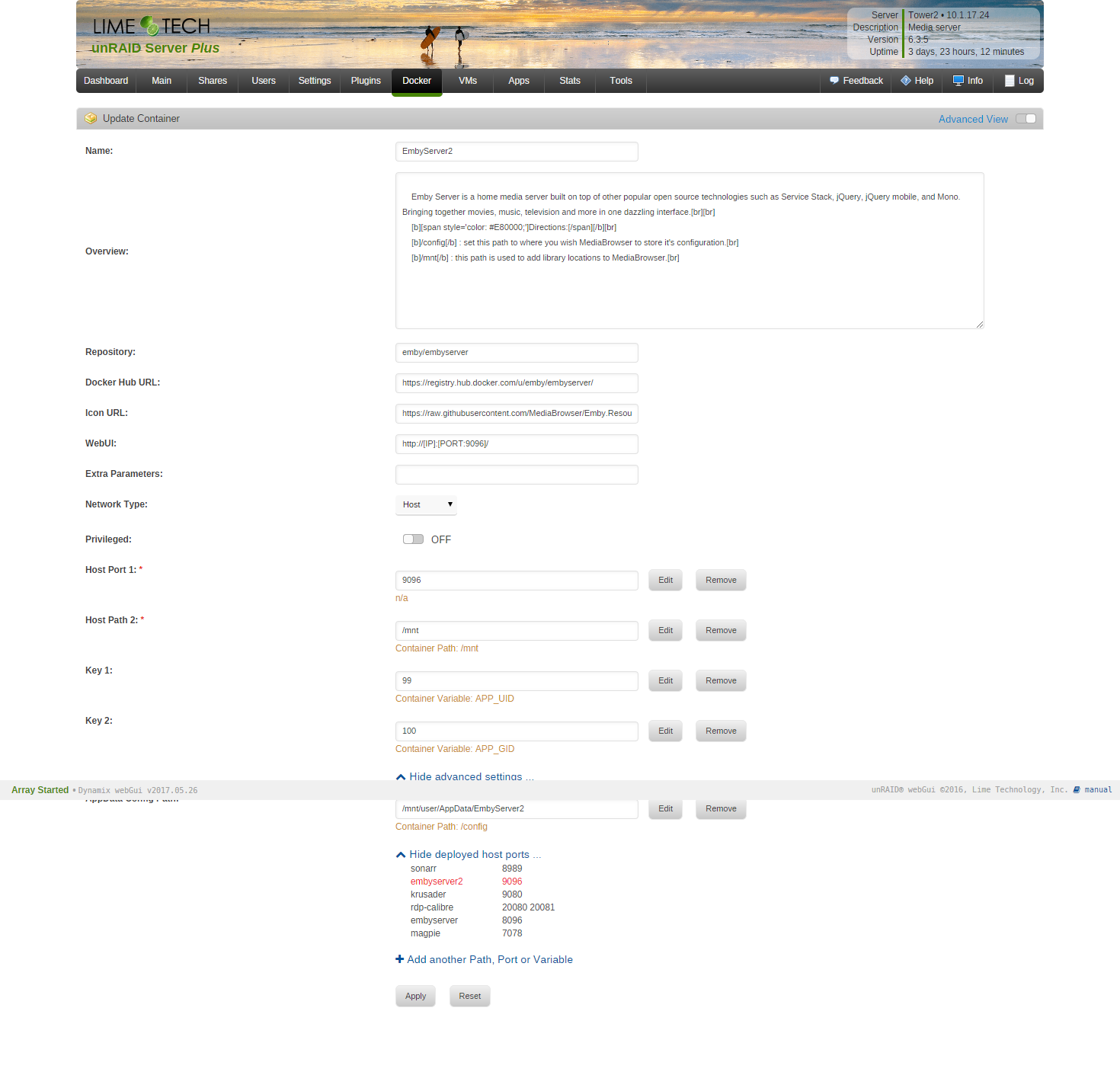

I think I'm missing something.  While following the instructions, I set the port to an unused port and changed the directories.  I also had to edit the WebUI string since it was still pointed at 8096.  I attached a screen shot of the settings.  The instance always fails at start up since it's still trying to use  {"EnableUPnP":true,"PublicPort":8096,"PublicHttpsPort":8920,"HttpServerPortNumber":8096,"HttpsPortNumber":8920,
And 8096 is already in use.
The only way I've successfully used the new instance is to shutdown the original and leave the port at 8096.  I was able to get to the set up wizard.5998f319bea6a_embysetup.thumb.png.a094643b8b11bd82354fc9a7e85e9c33.png
Ah   I missed that emby is running as network mode host   try switching it to bridge and try again.   If it still doesn't work then you have to find out all the ports emby uses and assign them individually (or upgrade to 6.4 and assign emby a different IP address)

Bridge mode solved it.  TYVM.
