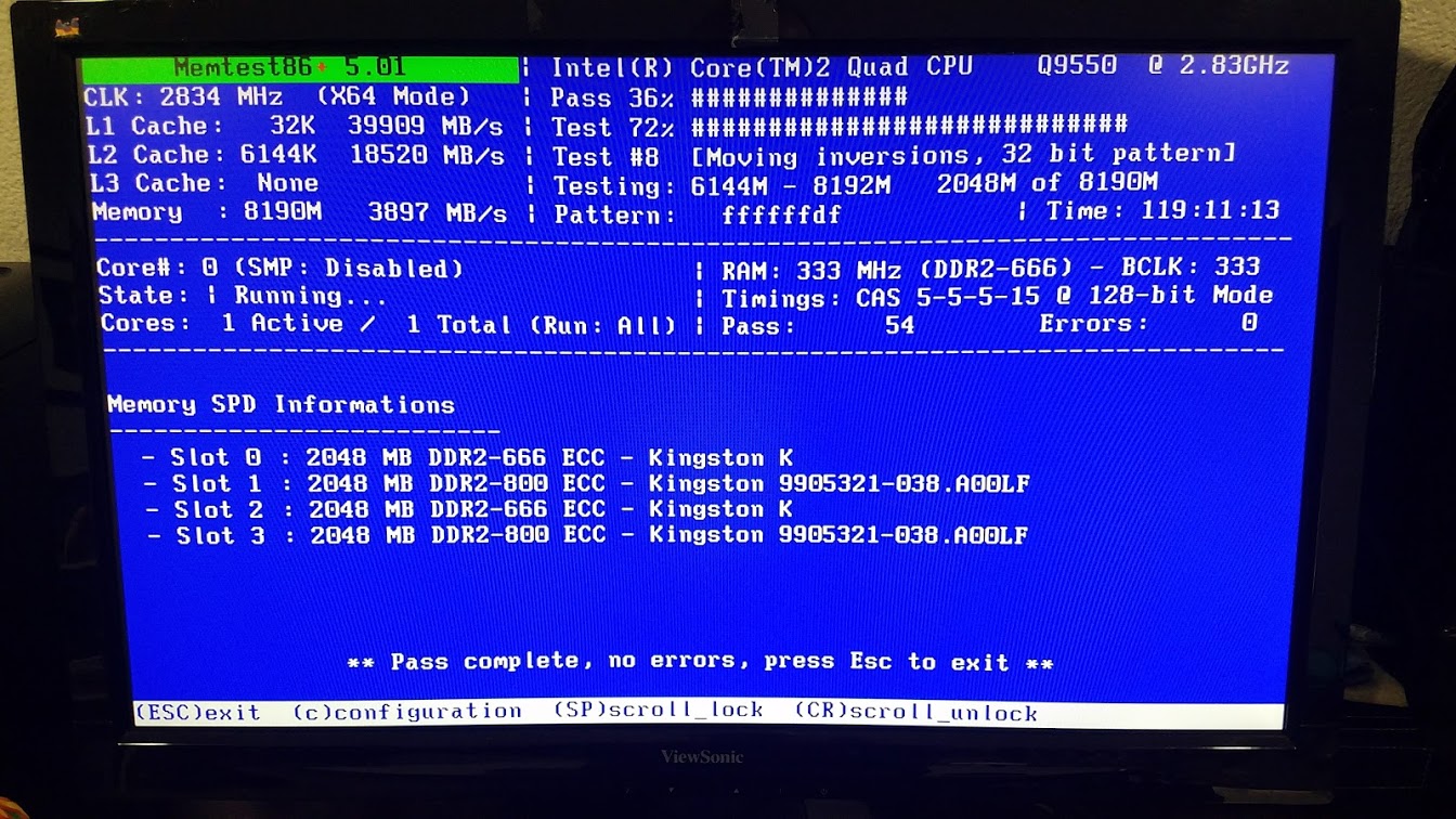

It's not normal to get filesystem corruption on so many disks at the same time, run memtest for 24 hours before attempting any more repairs, or better yet, move the disks and the unRAID flash drive to a different pc and try to repair them there.
OK - I can try both of those things.
OK, so I thought I was onto something, based on the previous feedback.  That it was hardware related, not disk related, which I still think is true, but I don't understand what it could be.
I ran Memtest for a lot of hours, with no errors.
