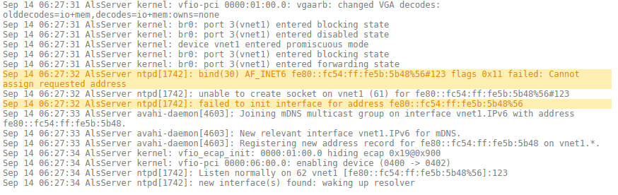

September 14, 20179 yr Hi, since the 6.4 i still have several boot issues with a win10 VM with nvidia gpu passthrough. mostly coming when there was a win update or i did a manual reboot. VM then starts up and stays on "Memory tested ok" page ... and often restarts the memory testing and always ends up there ... mostly a full reboot from the server resolving this, today morning now not, but i ll take a look further later if i can get it back without reverting back to 6.3.5. the 2nd win10 VM with intel gpu passthrough i never experienced this. screen from system log doesnt really seem to help (at least to me ) and from the VM log 2017-09-14 04:36:41.001+0000: starting up libvirt version: 3.5.0, qemu version: 2.10.0, hostname: AlsServer2017-09-14 04:36:41.001+0000: Domain id=2 is tainted: high-privileges2017-09-14 04:36:41.001+0000: Domain id=2 is tainted: host-cpu2017-09-14T04:36:41.053917Z qemu-system-x86_64: -chardev pty,id=charserial0: char device redirected to /dev/pts/1 (label charserial0)2017-09-14T04:37:33.257990Z qemu-system-x86_64: terminating on signal 15 from pid 7621 (/usr/sbin/libvirtd)2017-09-14 04:37:34.659+0000: shutting down, reason=destroyed2017-09-14 04:37:37.048+0000: starting up libvirt version: 3.5.0, qemu version: 2.10.0, hostname: AlsServer2017-09-14 04:37:37.048+0000: Domain id=3 is tainted: high-privileges2017-09-14 04:37:37.048+0000: Domain id=3 is tainted: host-cpu2017-09-14T04:37:37.085100Z qemu-system-x86_64: -chardev pty,id=charserial0: char device redirected to /dev/pts/1 (label charserial0)2017-09-14T04:39:00.465732Z qemu-system-x86_64: terminating on signal 15 from pid 7621 (/usr/sbin/libvirtd)2017-09-14 04:39:01.866+0000: shutting down, reason=destroyed Edited September 14, 20179 yr by alturismo

September 14, 20179 yr Author i assume its more a locked PCI slot or so, cause i also cant boot then any other VM using the Nvidia card (libreelec for example), or i also cannot start a fresh install with nvidia ... and i have a GTX1070, using OMVF Bios, i remember i used seabios before when i started with unraid, but last install was OMVF and worked flawlessly until 6.3.5, issues started with 6.4x. and yes, a clean reboot always solves the issue (shutdown, cold start or usually system reboot) thanks anyway next install i will try seabios again.
