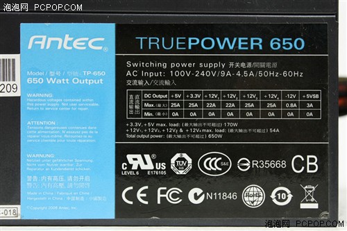

Does no problem if running less then 12 drive, since you change the power supply ( I know bigger then previous one ). But pls note the combine power of 3.3v+5v usually not more then 130w, it was tight for powerup 22 drive (5v part not 12v part).
Seasonic Prime 650 Platinum was 100w only.
Further check Antec Earthwatts 550, just 90w :S:S:S

Ahh..  Thanks.  I was thinking the 12V side for the motor was were most of the current for the drives would be but you may have something there.  I do have a Corsair AX750 (older but working in in another box) that is rated for 25A on the +5V rail.  I'll pull it out tomorrow and see if it makes a difference on the drive count.
Nowaday, that are hard to found a supply which have high combine power of 3.3+5.
Antec truepower 650 is the one which I use and have 170w. But I just try powerup highest 13 hdd only.
Edited by Benson
Tried the AX750, also hacked apart some cables and tested, there isn't much draw on the 5V rail for either the motherboard/pcie cards (30W max) or drives (2-3 watts a piece).  I don't have any free SSDs to test, they may be different.  The bulk is on the 12V rail for both the motherboard (CPU) and drives when they spin up.
