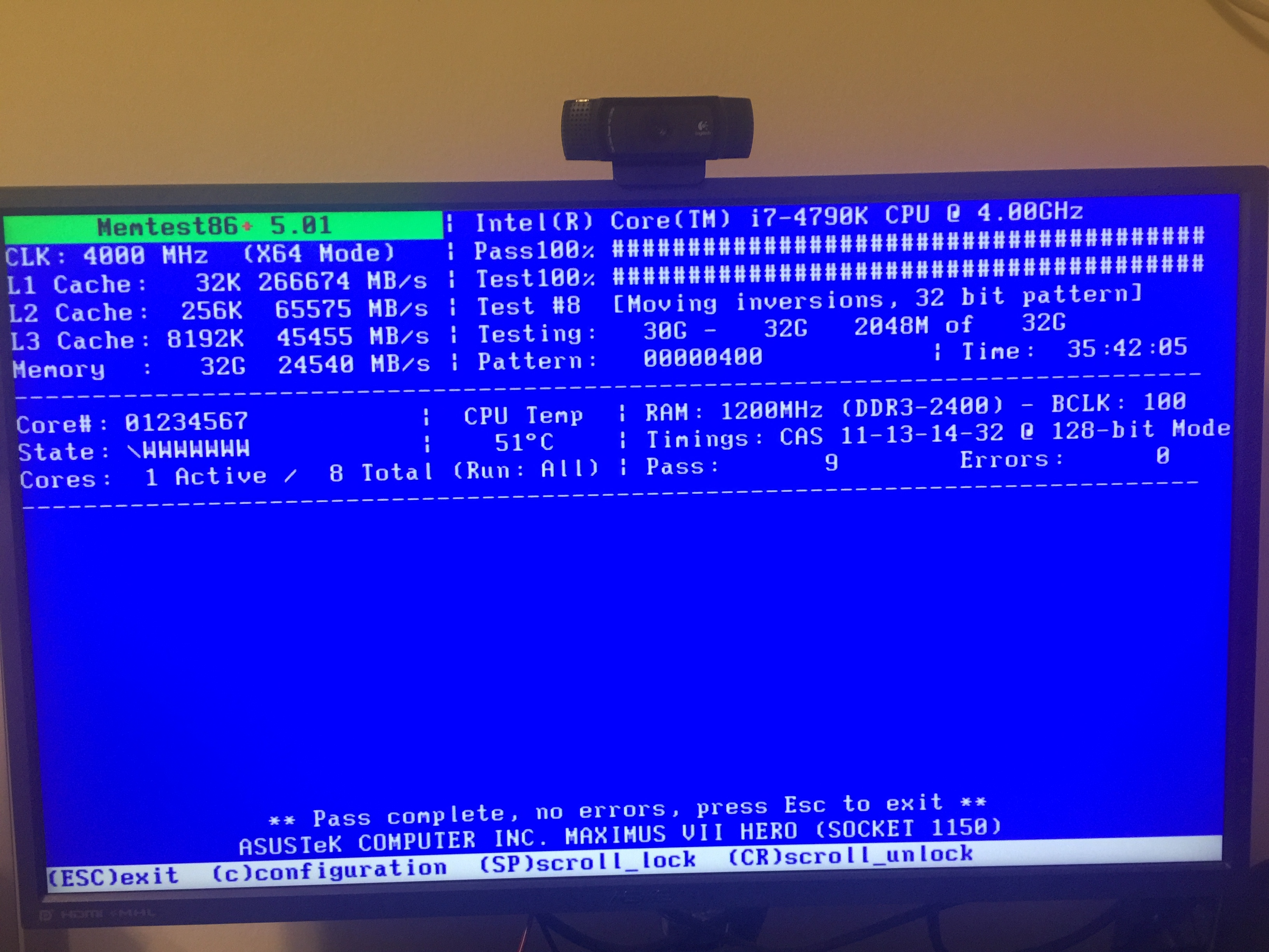

Hello,
I ran memtest for more than 35 hours and got no error a couple of days ago.
Today I re-run the parity check still found 40 errors.
Any other clue?
Unfortunately no errors on memtest doesn't necessarily means there's no problem, only the opposite is true.
