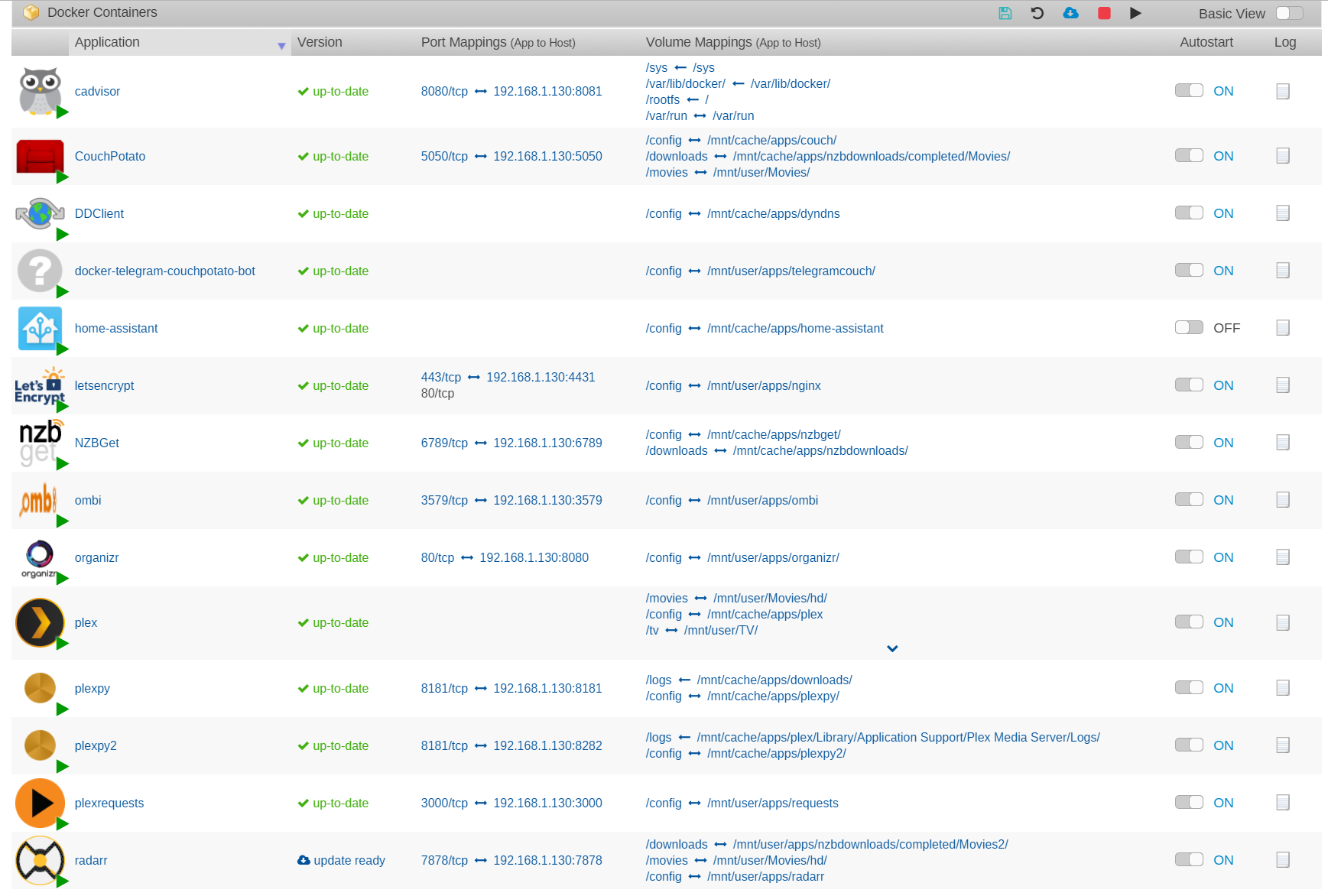

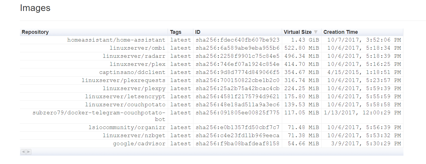

October 11, 20179 yr I got an alert my docker image utilization is at 100%. All of my dockers are configured to map folders to the cache disk. I fired up CADvisor and all of my dockers disk usage doesn't add up anywhere near to the 20GB I have provisioned. What else could be using all of the space?
