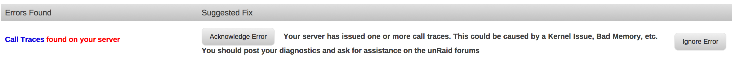

Reported "call traces" issue.
Lately the plugin Fix Common Problems have been reporting a "Call Traces" issue found on the server and recommended to post the diagnostics here, so, here it is:
monster-diagnostics-20171017-1313.zip
Yes, it turned out there was an issue with that drive and as a result I couldn't get a list on one directory of that drive. Running the xfs_repair solved that issue. Now, this is the second time that happens on that drive in a 3 week window. Should I be concerned about the drive? There's no SMART report on it and everything seems to work fine.
