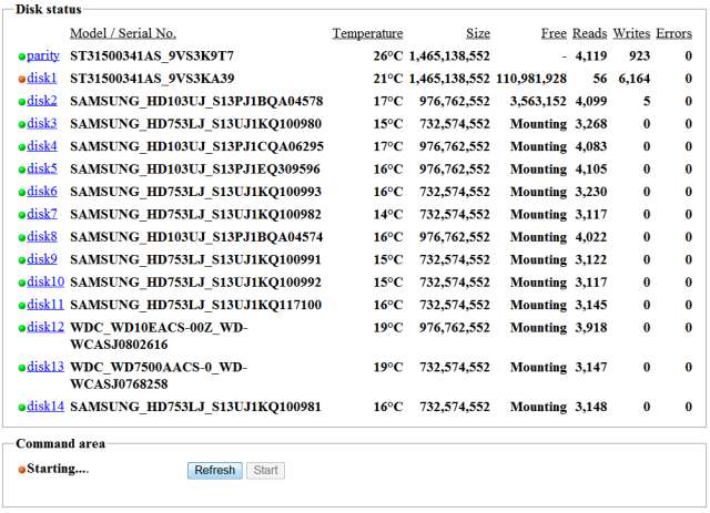

Uah, I just replaced a data disk with a new one. Hit Start and now I'm stuck as you can see in the scrrenshot. There's no way to sto/reboot/change that situation.
What should I do?

It can take as long as 5 or 6 minutes for the translation journals to be re-played.  (assuming that is what is happening)
Wait a bit longer and press refresh again.
See if you can grab a copy of the syslog.  Instructions in the wiki under troubleshooting.

Yes, several minutes later it looked promising. I hit Stop and Start (just to be sure) and now Data Rebuild is working. BUT 5.000 Writes to the parity disk after 3% do make me nerveous. Why does data rebuild write to parity???

They were not written to the parity disk during the rebuild.  They were written to the parity disk when the disk having its journal replayed was written to.  When it is replayed, the parity disk is kept in sync with the writes.
Same thing happened when I just re-started my server after I ran out of RAM using ffmpeg and handbreak.
I've not written anything new to the server but I show
5104 writes to the parity disk and 5037 writes to the data disk.  (the extra "writes" to the parity disk were the other disks in the array mounting themselves)
My display showed "mounting" for over 2 minutes.  Look at the line below where I highlighted the time it took in RED
I've seen syslogs posted where it took over 5 or 6 minutes.
